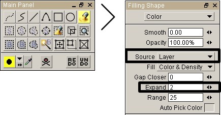

Hi Vakis,
this is a common question and tvpaint has a nice solution
you were already close....
you should indeed choose 'expand selection'
but to prevent the fill from eating away the anti-alias you should set the paint mode to 'behind' (instead of the default 'color')
this gives a perfect result
still better....:
there is a new feature to keep line and color seperate throughout production,
color your drawing on a seperate layer
(set the source in the fillshape menu to display )
this makes it much more easy to later change a color without affecting your lines

Here are the Expand and Source Layer options : :D
lesson n°5 in the TVPaint Animation Manual
lesson n°6 in the TVPaint Animation Pro Manual
