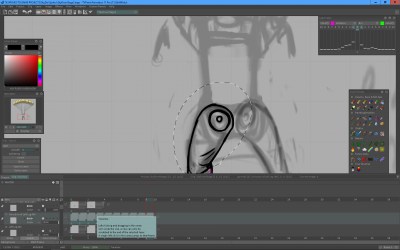

Well well,
So here, look at this, there is still something fishy with this frame,break stuff.
I select something, cut to layer, it creates all these frames. I try to unclick autobreak autocreateframe etc. from previous layer. But still creates all these frames instead of keeping same amount of instances. Imagine If I have an even longer animation, and I have to manually go about with all these 1000k frames? Did not have these problems with TVP 10.5
I have a Screenshot too

agree this should be fixed but.... there is a simple, one click, solution:maxrobert wrote: ↑05 Apr 2017, 21:03 Well well,
click recompute in the animator panel (standard in v10)
In v11 recompute is in the "handy custompanel" under "set exposure", the icon looks like this: =?
and its caption says "erase superfluos images without changing the timing...
Re: Shape Transforms in tvp11, Apply to only heads not frames
You can also use the Cut brush tool instead of selection.I select something, cut to layer, it creates all these frames. I try to unclick autobreak autocreateframe etc. from previous layer. But still creates all these frames instead of keeping same amount of instances. Imagine If I have an even longer animation, and I have to manually go about with all these 1000k frames? Did not have these problems with TVP 10.5
Also, if you lock the layer, using "cut to new layer" should not affect the original layer.
the original layer will also stay good if you switch off 'auto break'
but you would expect the new layer to also have the same 'none broken' timing as the original.
so it has to be fixed.

Now, I am looking forward to when it is fixed. The devil is in the details, so please, please, take your time and please look into this, no excuses, no "use this" instead. I'm not going to manually put stuff in with a cut brush etc. It is not a brush issue. Just look into this and fix it tvpaint crew, ok? If not, well...
And yes what Peter said above, it is not the original layer that is broken it is the new layer.
