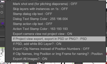

There's something I'm not understanding about your Storyboard Tools Export Script. When I hold Shift and click on the Export Storyboard Diapos button , I get various options , one of which is to If Project View Export as PSD or PNG. If I select PSD it still exports the panels as PNG. What am I doing wrong ?

It's because you export the camera view i think, try to disable it?
Future version will be able to do it but for now it can't I think

I turned the camera view off , but I still can't get it to export my Clips to PSD . Instead it exports the storyboard panels as individual PNGs.NathanOtano wrote: ↑07 Oct 2021, 17:44 It's because you export the camera view i think, try to disable it?

There is definitely cases where the code exports as PNGs cause it doesn't make sens to export as PSDs, I just don't remember which options forces PNGs D:D.T. Nethery wrote: ↑08 Oct 2021, 16:49I turned the camera view off , but I still can't get it to export my Clips to PSD . Instead it exports the storyboard panels as individual PNGs.NathanOtano wrote: ↑07 Oct 2021, 17:44 It's because you export the camera view i think, try to disable it?
To me you need :
- Export Camera view : OFF
- If Project view etc : PSD
To me the rest doesn't change anything, but you may try to toggle them on and off just in case (you can try to set export all images to off maybe? If it works that way, you need to break all instances in the clips I guess to have all your images exported as psd). You can also try to toggle the two options above on and off just in case there is a bug but to me it should work fine
Sorry since i'm not working on the last version on the forum I can't help much more
