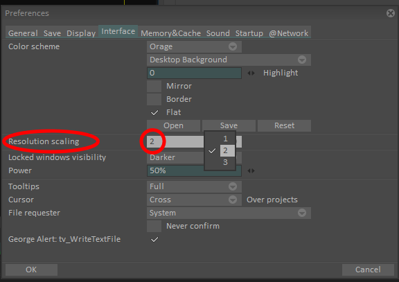

Hello everyone,
Here's a tip to improve the display on the new Mobile Studio Pro.
Go to where TVPaint Animation is installed, then right click on "TVPaint Animation 11 Pro (64 bits).exe", and click on "Properties".
Then, go to the "Compatibility" tab, and check the Disable display scaling on high DPI settings
You can also change the scaling in TVPaint Animation (especially on the MSP 16 which is 4K).
Go to the Preferences panel (by default Shift+D, or Edit > Preferences), then go in the "Interface" tab, and change the "Resolution scaling" from 1 to 2:
