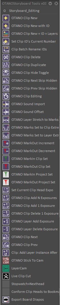

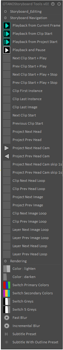

I'm happy share with you a set of scripts I created related to storyboarding (especially for animatic work with tools for editing and sound)
It was made for Disnosc, my company : https://www.disnosc.fr/
So they idea behind this was simple : Managing editing in TVPaint can be quiet difficult sometimes because even if you use the timeline view to edit you storyboard you still have some problems syncing sound correctly.
I used Storyboard Pro and missed the drawing and animation features of TVPaint, so before those scripts I was always drawing in tvpaint all the frames and editing it in Premiere or After Effect (sometimes even storyboarding in after effect...). But the back and forth between the softwares annoyed me because I needed to draw on sound directly and TVPaint was almost there with the timeline view... Took some hours to make it work for my own workflow, maybe it can help others so I'm sharing this :wink:
All the scripts in this panels will keep your sound in sync with your clips, you have some of those functions already in TVPaint but I replicated them with George scripts so they also offset sound if they change the timing of your cuts.
For example : if you have a long dialogue in timeline view synced with multiple shots at the end of your storyboard, changing the timing of one of the shots (or creating/hiding/deleting clips) at the beginning of your project with those buttons keeps your dialogue in sync at the other end.
That way you can have sound across multiple shots without having to embed them in the clip with the "split track to clips" option that is not really convenient when you're editing your animatic. I found that sound splitted in different clips that will each change in length can be hard to manage.
A lot of those tools work with mark ins and mark outs so you can change your editing + sound without touching your layers. It will be difficult for your habits but if you want to keep your sound in sync using this panel you have to avoid using tvpaint's interface (like hiding clips, setting mark etc...).
The "Clip Editing" button is your main tool and most advanced script for animatic so use it well! You can avoid using a lot of buttons with this one.
Here is a breakdown of some buttons (you also have some descriptions if you let your mouse over panel's icons) :
Spoiler : :
- Play from current frame : If in project tab, play your storyboard from current clip and then goes back to current clip and image (tvpaint was going back to the first clip instead). Plays your clip as usual if in clip tab.
- Play from clip start : Same than above but begins playback from clip start instead of current image (need it all the time because when selecting a clip TVPaint goes to the last image you were working on in this clip, and when in thumbnail view you lose time going back to the beginning of the clip for playback)
- Clip New : Creates a new clip with same length than your current clip (when it timeline view it's hard to manage clips with a length of 1 frame). Layer is already stretched to the end of the clip so you can draw on it in timeline view without having to go to the first frame (I advise you to deactivate autobreak/create by default to avoid breaking your instances). Also have the same name plus "_b" to avoid having a space in the name (in french version the default clip name has a space). And offsets sound regarding the length of the new clip.
- Clip Hide toggle : Toggles clip hide state and offsets sound (doesn't undo properly for now so be carfeful to use the script again instead). If you use shift when clicking it will also offset the sound right net to the clip, it's usefull if the sound of your clip shifted left when you hid your clip and you want to put it back in sync when you decide to unhide it.
- Clip Delete : Deletes current clip and offsets sound.
- Clip Duplicate : Duplicates current clip and offsets sound. If you use shift when clicking the sound doesn't offset so you keep it in your first clip.
- Clip Next/Prev Skip Hidden : Just a shortcut so you can navigate between clips by skipping hidden clips (useful especially in clip tab when you're cleaning your storyboard).
- Clip Editing : This one is great! Instead of sliding at the right of your clips in timeline view to change the timing of your clips or managing your mark in/out, you just input the new length you want for your clip and it sets your mark out at the right place for you regarding your mark in. Of course it also offsets sound. If you use shift while clicking "ok" it will compensate your change in length in the next clip so your global timing for the two cuts does'nt change. I use it a lot because it's more precise than sliding in the timeline view and faster than setting marks in clip tab. Also it's a great learning tool because choosing your own timing in frames, you know what you do and can begin to spot which shot require which amount of frames <3
- Sound import : Opens a file requester to import a sound file and offsets the sound to your current image (TVP puts it at the beginning of the timeline which is a little annoying for long storyboards). Be aware that it doesn't work if you have unusual characters in your file's path/name.
- Sound offset : Just offsets sounds after current frame by a chosen number of frames.
- Layer Stretch to mark : Usefull script to stretch your layer to your mark in and mark out. I use it especially for camera work because the interpolation time follows the length of your layers and not your marks. Use it also when my layer's post behaviour in on hold and I'm out of the instance but need to draw on it at current frame.
- Marks set to Clip Extremes : Sets your mark In/Out to the first/last image of your clip regarding all your layers. Usefull when changing timings in your clip and you want to keep your marks at the extremes and offset sound.
- Marks set to Layer Extremes : Same than above but sets marks to your current layer extremes instead.
- Markout Inc/Decrement : Just a way to precisely fine tune the length of your clip, it will move your markout one frame left or right. If you use alt and/or ctrl it will offset 5 frames, 10 frames will both shortcuts. If you use shift is will compensate the change in length in your next clip so you keep the global length of your clips. It also offsets sound, of course.
- Markin/Out Clip/Project Set : Sets your mark to current frame (in/out and for clip or project regarding the button you use), and if there is already a mark at current frame it toggles the mark instead. The ones for clips are offseting sound, and the ones for project are nice if you are in Inlay View and you don't see the remote under your canvas to set your project marks (which is what I personally experience).
Important things to know before using the panel:
- Please note that the scripts will not work properly if you have spaces in your clip names (doesn't happen unless you split clips/have another language (like french) in TVP). To fix that I advise you to use this nice script by Mads Juul to batch rename your layers.
- Also note that there is some restrictions using Mark Ins in negative frames, because george script doesn't handle negative frames properly. So please use only positive frames :roll:
- I'll update the panel soon with timing tools that also move markin/out. That way you'll be able to reproduce a workflow like when you work without marks and the length of the clip changes regarding layer length. For now I advise you to add the "Marks Set To Clip Extremes" to your actual buttons and/or shortcuts, will almost do the job 8)
- Importing sound doesn't work with unusual characters for file paths and names (so beware of spicy spaces D:).
I'm open to any suggestion, new tool idea or bug reporting, I can update the scripts quickly so don't hesitate to ask.

Todo List (for me and if people who wants to know what's next) :
Spoiler : :
- Two scripts to go to the next/previous image of the clips regarding all layers and automatically go to next/prev clip (I had some nice help from MJ and will do my own script). Will do the same with some basic shortcuts to move in timeline (maybe an option button to choose between looping on the clip or going to next clip and for steps like in the flipping panel)
- Maybe a script to have the frames of the clips following the global frames of the project by moving layers right and settings marks.
- Adding timing tools working with markins and markouts, with the new script you'll be able to have your marks updating even if they are not at the extremes of your script.
- A split clip button that renames splitted clips without space (and check if there is no other case when you end up with a clip name with unusual characters). And that works if your instance is in hold mode and doesn't stretch far enough.
Bugs to fix :
- Make Delete Clip work when there is only one clip in project.
- Make Negative Markins work with a script to normalize the clip to frame 0 by moving everything to the right.
- Undoing clip hide toggle doesn't unhide/hide clips.
- Importing sound doesn't work with unusual paths for files
=> Updated to V3 : 07/08/2021
OTANO Storyboard Tools v03.tvpx

Well here it is :)
Lot's lot's of new tools since the first version, I don't have much time to create documentation but most of it is self-explenatory
Keep in mind there is weeks-worth of work on this so don't forget to credit me or my studio (Disnosc - https://www.disnosc.fr/) when using it.
Summary :
- First section is about editing storyboards (adding images, modifying exposures, changing mark ins/outs, playback, sticking a layer to the camera, even a weird "live cut" script to cut where you stop your playback).
- Second section is brand new and actually mandatory for storyboarding in tvpaint, i'm sure you'll like it more than expected... It all about flipping in your storyboard and automatically going from clip to clip without going back to project view. We discussed about it with MadsJuul years ago, I did my own version of those with the behaviour I wanted.
There is also a stopwatch shortcut to kind of time instances heads with a shortcut with the stopwatch, and then a script to conform it to bookmarks created with the stopwatch...
- I added in the third section small tools to help with rendering : quick blur, color switchs and luminosity increments
+ I added a soon to be released script to export a storyboard project as a diaporama, exporting all your visible clips while removing your temp timings for pitching and editing, as png or psd.
It skips empty/duplicate frames but stops to render the image if ANY layer has an instance head at that position, + it can write dialogs on bottom and action on top, and it can export clip names instead of project frames. Used in combination with the "Clip New + ID", you can have a pretty smooth time editing your exports and updating it...
OTANO Storyboard Tools v02.tvpx
(4.24 MiB) Downloaded 834 times
I'm not sure but my sound import scripts may be a bit broken, some other scripts may depend a lot on your personnal settings that I can't predict. Please tell me if you encounter any issue with some buttons so I can fix it.

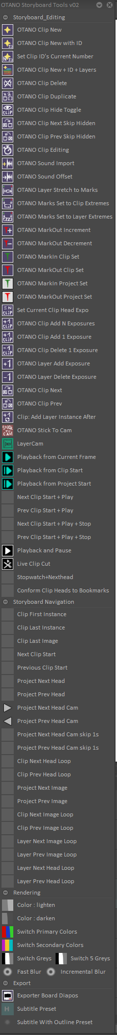

Well I did an upgrade with some flexibility for my export script and managing clip Names ("IDs")
(4.35 MiB) Downloaded 956 times
  • I added a button to batch rename clips in their current order
  • For the "Export Board Diapos" script I added lots of options, among them :
    • Now you can choose between exporting all individual images and not just the new instances (I added this cause you can't normally export a whole project in psd with layers, only individual clips + you can't export clip names that way too).
    • You can also choose if numbering follows frame number or instance position (so you get consecutive numbering when exporting only heads, or get the actual frame heads appear)
