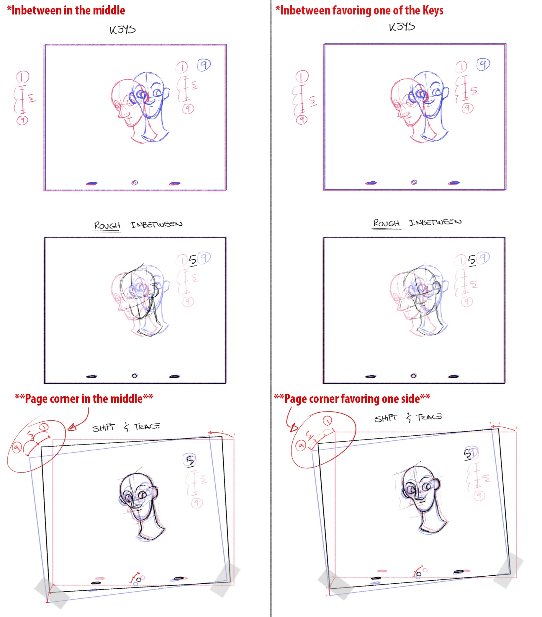

I duscussed about it with fabrice, and I would say that I need more than 3 drawings. Don't get me wrong, for inbeetweening beetween two drawings 3 drawings is enough, maybe I'd really need 5 images at the same time on my screen only to check arcs. But having multiple drawings having the same reference point like how I was suggesting it with my script, we would be able to animate "on the spot" like in old days of animation (it's juste a whole definitive out of peg following the camera, like when we render camera in a project). But I really need to have this "on the spot" animation on my current project to avoid loosing my developped animation (I could switch beetween the two, which is unprecedented)
What does it mean it terms of the script I made? I choose the same reference point across all my drawings, it's linked to the instances, and when activating out of peg it automatically matches reference points of the instances in my lighgtable (depending on lightable mode). Let's say I have a walk developped in a long background : I put the reference point of each frame at the center of gravity of my character and I'll be able to see the spacing "on the spot" with my lighttable, meaning that I can inbeetween my up and downs and flip threw it without bothering with how much the character goes forward/backward.
One of the thing I heard this summer is that people wants to flip out of peg but by being able to draw on the out of peg drawings. So i'd add that while going from an instance to another, it would be nice that the canvas translates to match the drawings in space. Much like the "follow camera" option we have.
In fact I see everything linked here. Instances with reference points, Lightable like what we have now, and Moving Canvas option to match the reference points while flipping.

I also always draw my rough inbeetween before using out of peg because I need to know where the drawing here regarding space and arcs. I use OOP for tie down beetween solid poses.
But xhen I out of peg my drawings, I still have arcs regarding my rotations in space of the things I moved. My out of pegged head is still rotating by itself right? It's for some realistic and advanced animation, yep, but I'm using it all the time. The same way you need arcs in space, you still need them when using out of peg even if they are smaller, to manage your rotation spacing of your rough inbeetween before actually matching rotation. Now that your motion is closer, you still need to see how it eveolves in space (it's not just arcs, it's also for spacing).
I'd use 5 drawings to draw a new rough inbeetween for rotation (i'd have scaled my LT images already so I focus on getting the right rotation spacing), then I'll match my OOP rotation so every drawing is matching perfectly. Then I'll use just 3 drawings for tie down/clean, flipping my drawings with my modified MJ OOP script instead of using transparancy so I can keep everything solid.
I know what I talked about it some advanced thing, but it's of the same us as the "follow camera" option we have, but more advanced as the OOP also adapts when you flip and not just the canvas.

Thanks Fabrice, I understand better now. Lets say 5 drawings for me then : ) but 3 most of the time.
To slowtiger, i'll also use oop while storyboarding (just 3 drawings) to move a character (pos and size) and change an expression consistently beetween two narrative poses. In fact oop became an inherent part of how I draw in time, even for rough things, not just as a refining tool. Almost like how you would use lighttable even if your not inbetweening.
