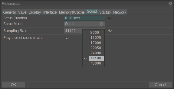

Re: Possible increaseing the Sound Rate "32bit/384KHz" ?
From the informations, I have for now :
When importing, the sound is converted to fit what is selected in the Preferences Panel (nb : 2 chanels sound only) :
When exporting, it should be lossless.
Mike will check and confirm.

Nice! That's nice to know, i forgot this tab. And is it 16 bit or can it be 24/32 depending on the file?
