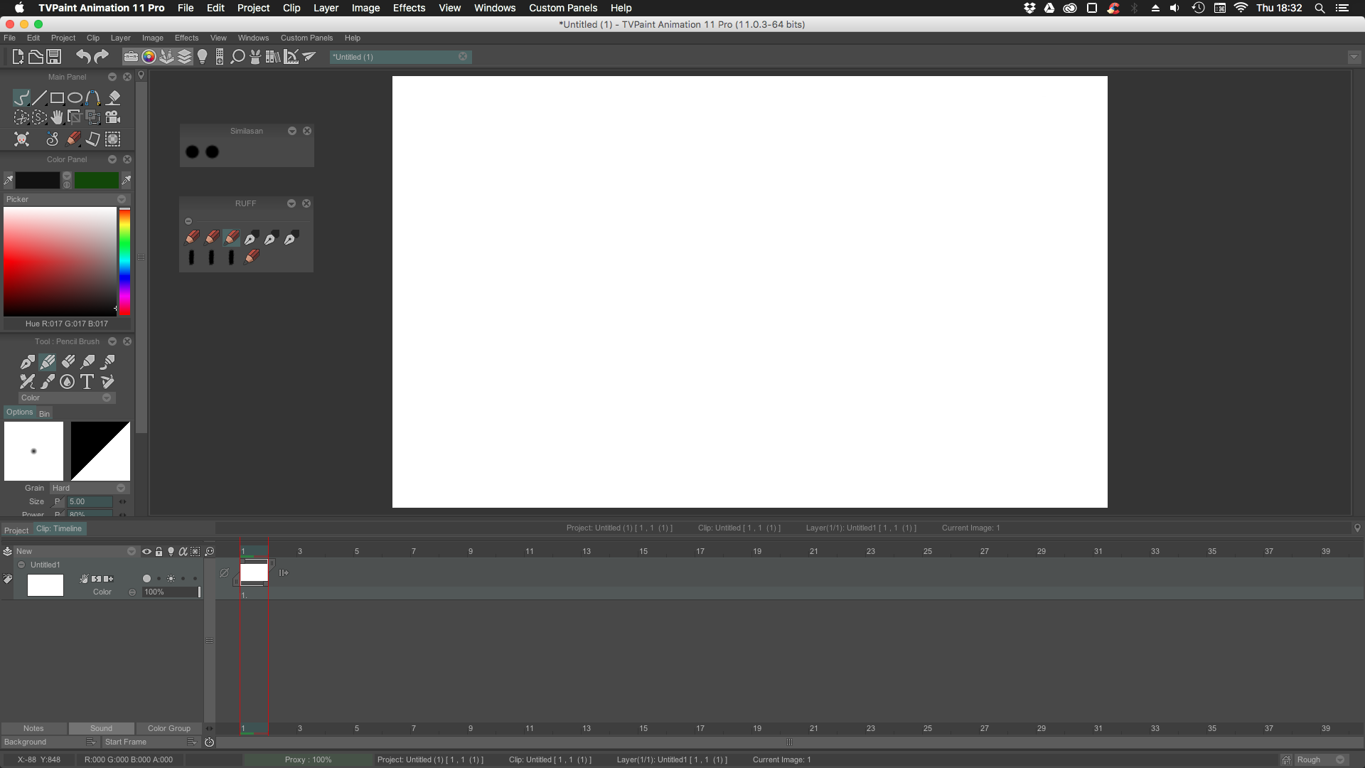

(pls. also check the pictures i attached)

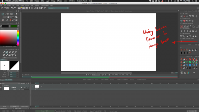

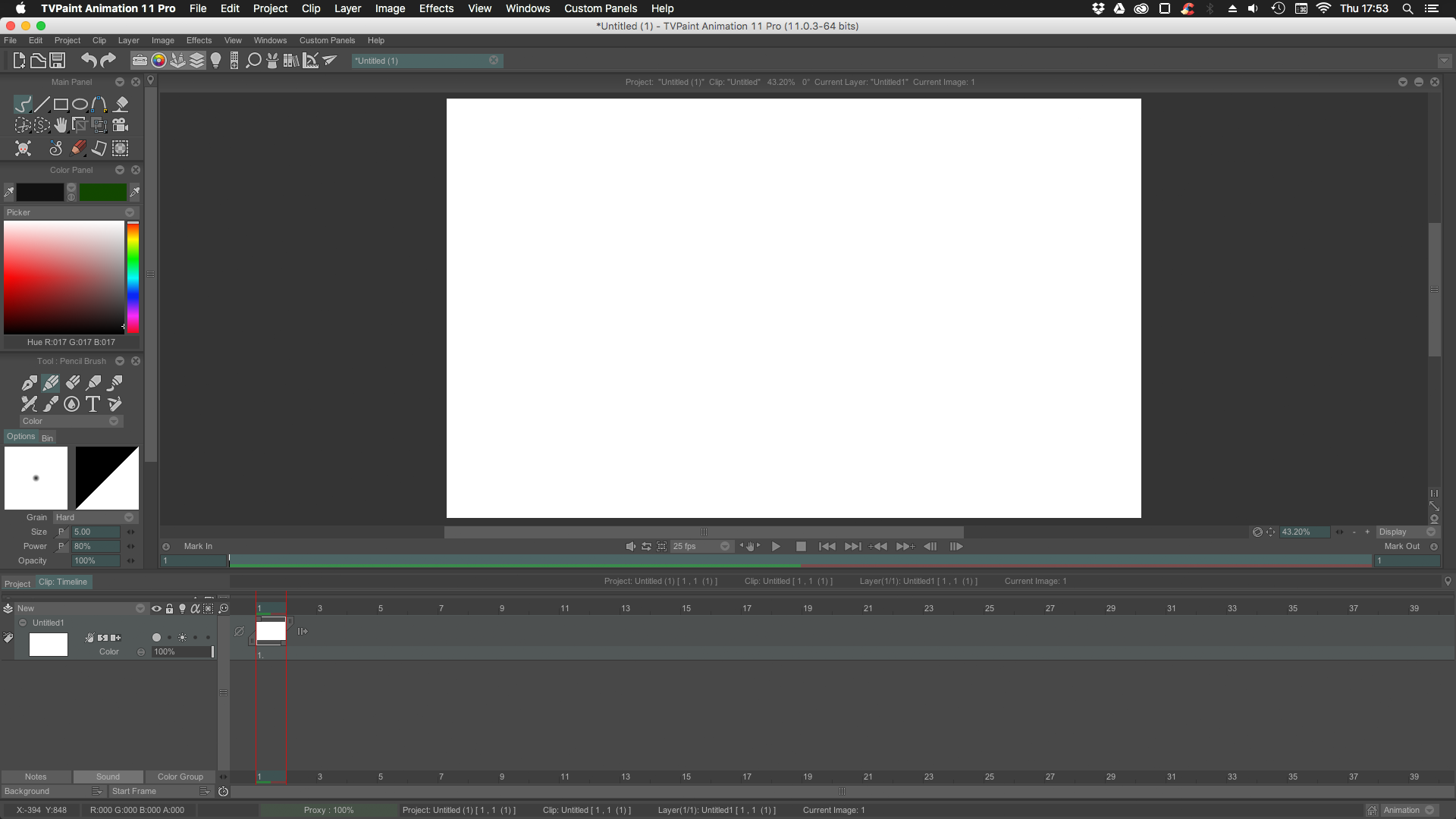

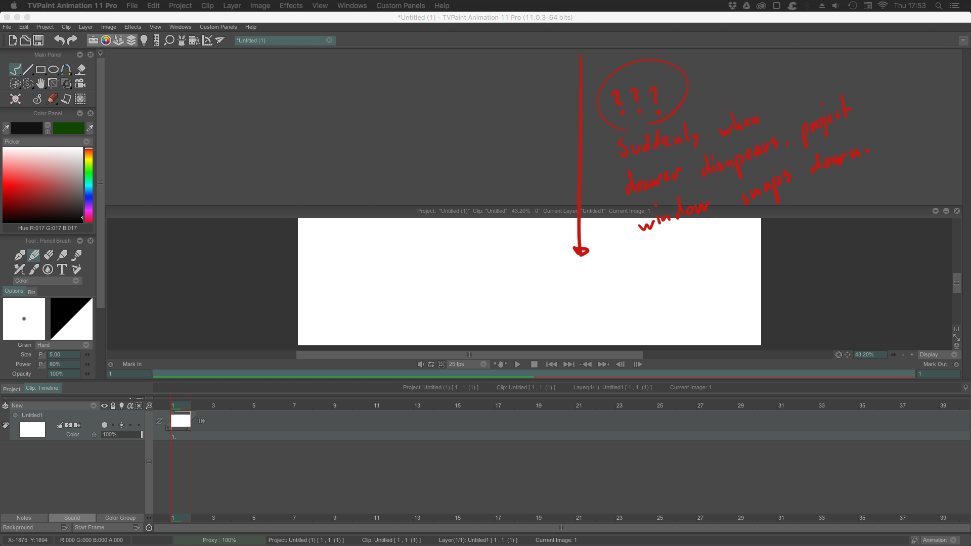

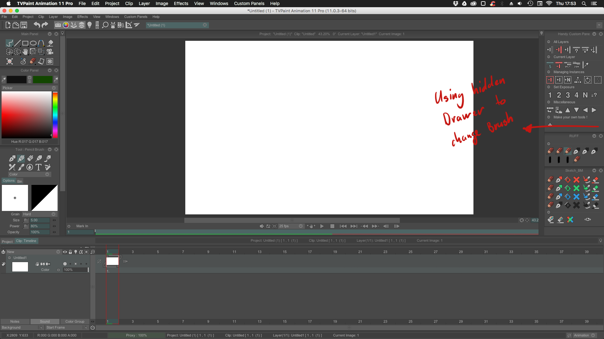

Whenever i open a hidden drawer on the side of my screen and the drawer is hiding again, the Project window "snaps" down to half the size.
And i don't mean the Zoom but THE WINDOW ITSELLF.

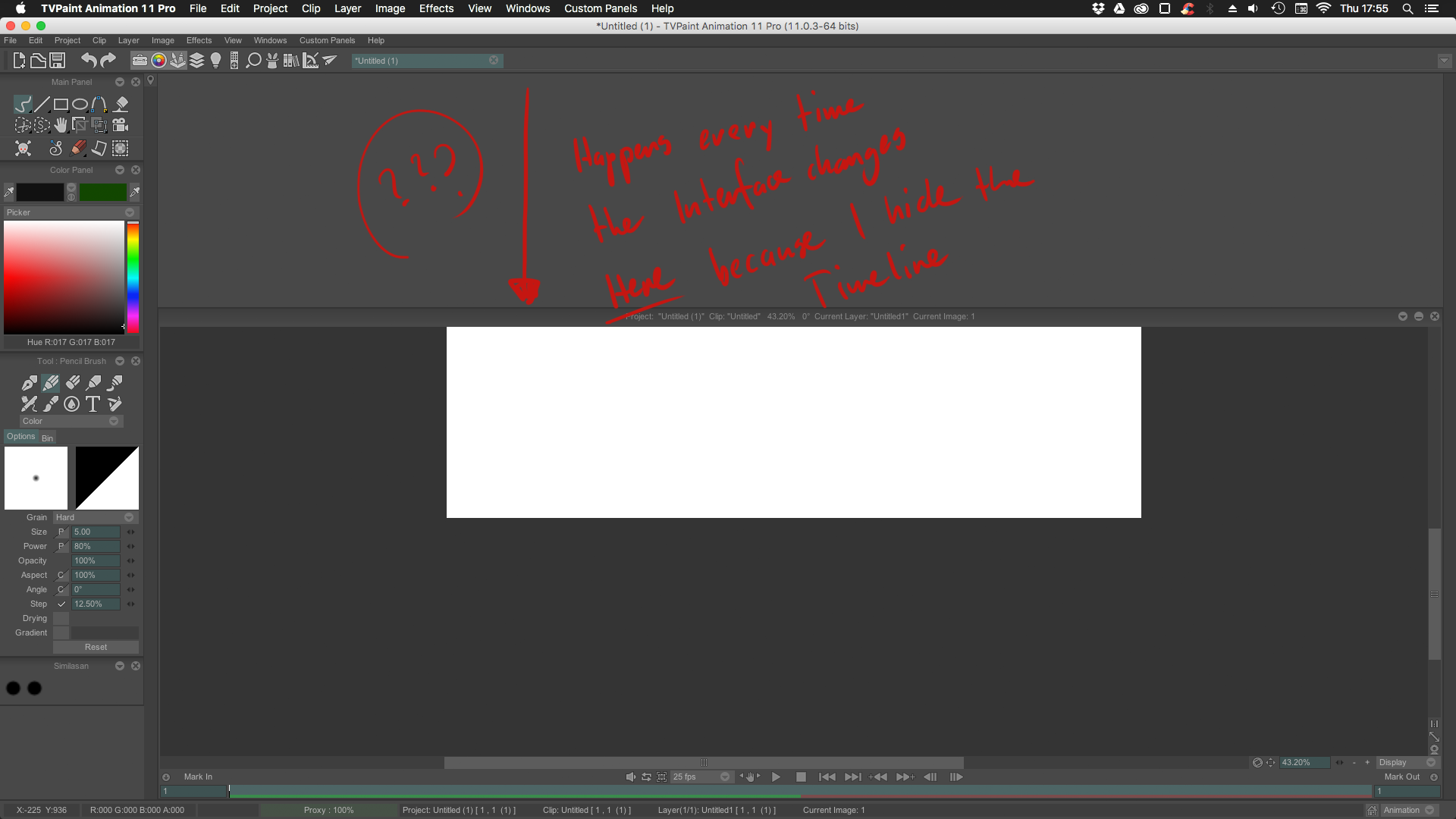

Acctually it does this EVERY TIME the Layout of the software is changed.
So for example, also when I hide the Timeline (0 Key) to have more space to draw, ZAP! the project window snaps down.
And then I have to double-click it two times, or even manually adjust it's size, to get it back the way it was.
I noticed that the Issue is gone when i use the Inlay View for my project window. (Menu/View/Inlay View)
I assume this is bacause then the project "window" is not really a window then, but is in the background of the whole software window.
But thats not really an option for me as a troublefix, because I need the Play and In and Out Point Buttons a lot.
Important: This only happens on the cintiqe!
When i open hidden drawers on the imac Screen with my mouse the issue does NOT occure.

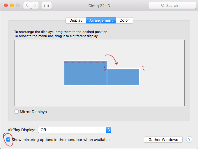

Re: Project Window Bug
Hey Elodie
Thx for your Video it gave me an idea. And voila I found a little workaround thanks to it.
Maybe it also works for your problem?
The Workaround is like this:
Set the cintiq as primary monitor and the window bug disapears. This is not a final solution because I actually don't want my cintiq to be the primary monitor.
(Becauase now of course, every application opens on my cintiq and stuff like that)
But at least i can get rid of the bug, if I have to work longer projects in TVPaint.
