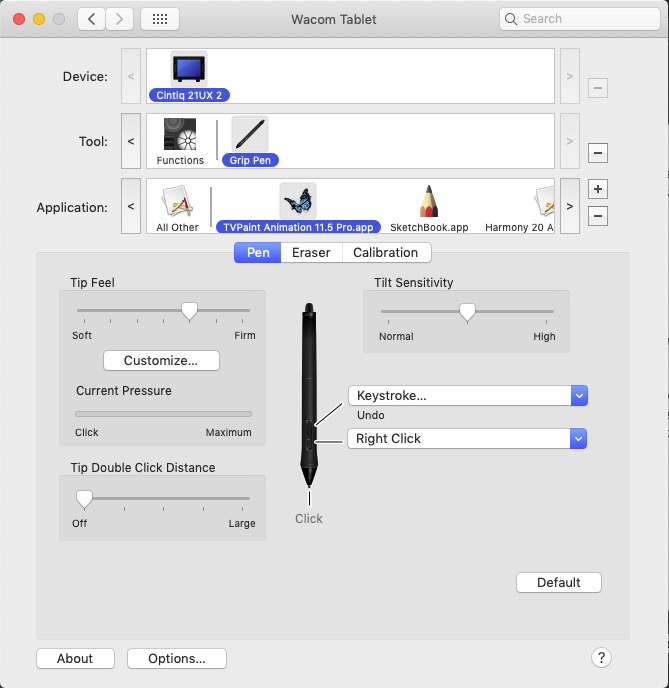

A very useful function in TVPaint is programming one of the Wacom stylus buttons to Right-Click , which makes it an ERASER if you press it when you are drawing. So, if you are drawing with a Pen or Pencil tool , then press the stylus button that is programmed to Right-Click it instantly turns the pen tip into an eraser. Then upon releasing the stylus button it instantly reverts back to a being a Pen or Pencil drawing tool and you can continue drawing.

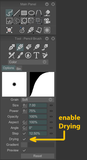

So, I am asking that this function should be prominently mentioned as an option for Erasing. It should also be mentioned that the drawing tool must have DRYING enabled to allow for the continuous use of the Right-Click erasure feature . (if drying is not activated then you can use the Right-Click erasure feature as long as you are using the Pen or Pencil drawing tool , but if you switch over to a different tool , such as the Transform tool , then go back to the Pen or Pencil drawing tool , you will no longer have the ability to use the Right-Click erasure function. Therefore, activating Drying is a must.)

If I don't have Drying enabled then I can erase with RMB (assigned to Wacom stylus button) as much as I want , until I switch to another tool (such as Transform Tool) because then when I switch back to the Pen tool the RMB erasure does not work anymore . But if drying is enabled it will always work. (maybe this is a Mac thing ? I would be glad if I could use it without drying enabled.)

The RMB for me was always an integral part of the software - without it TVPaint is like an eagle without wings - this functionality literally makes half of TVPaint. It's not just an Eraser - it is used also for zooming the Canvas, the Timeline and the Project View, right clicking on the menus, putting the Selection tool into a "Subtract" mode, Fill bucket and Brushes into Erase mode, etc. All you need to have is Wacom pen side switch set to Right Click, which is usually by default. I never ever had to read the manual - I was introduced to the power of RMB in the first minute after opening TVPaint for the first time, and it was so intuitively clear to me, that I can't imagine other people not using it...
About DRYING: Drying is an important part of this function, and it doesn't necessarily has to be always ON. When drying is OFF, the brush will erase ONLY the recent strokes until the tool is changed. And it will delete ONLY the strokes of the last tool while keeping whatever was underneath intact. It is a little bit more like a "history brush" and not exactly Eraser. This function is very handy when working with only one brush above another if you want to quickly erase without loosing the previous strokes. Also - don't forget that all these brush settings are remembered when a brush is created and it's very easy to change them to your liking - just set whatever parameters you prefer and "reGrab" the Current Tool in each Tool's Edit menu and voila - you have the tool permanently with Drygin ON - you only do it once. I guess that most TVP default brushes were created like this a long time ago, and just were never changed.

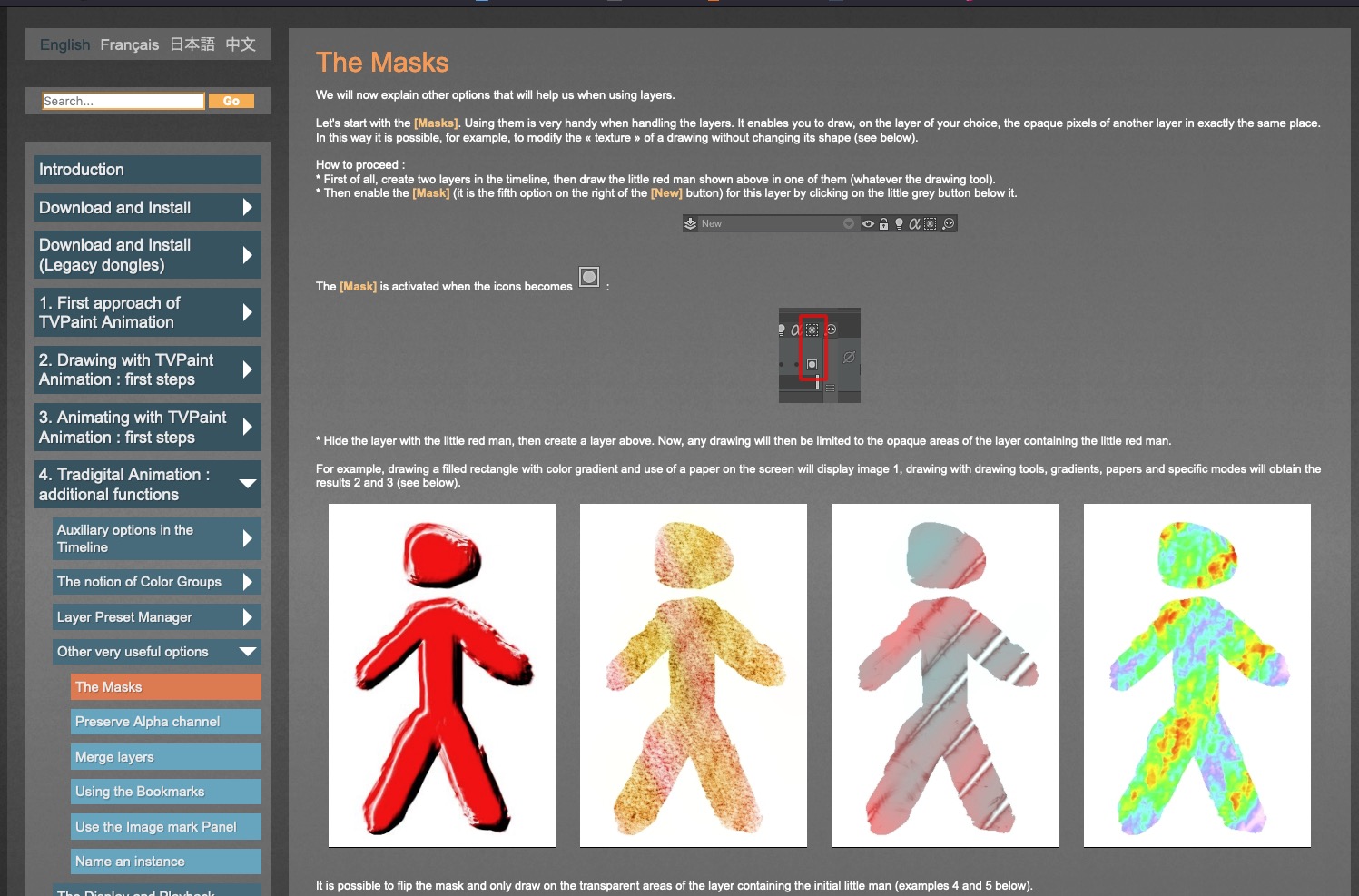

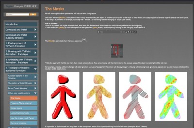

In the user manual the function of the Stencil is described as "Mask". If a user seeks for "Stencil" in the User Manual they won't find this function because it is categorized under "Masks" in the User Manual. This is confusing.
https://www.tvpaint.com/doc/tvp11/index ... ions-masks

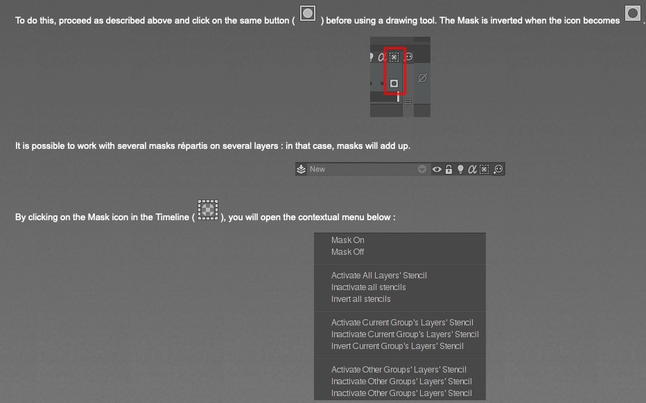

In the user manual this is what you will find, describing the function of "The Masks" , "Mask ON" and "Mask OFF" (but also referring to the function as "stencils")
Screen Shot 2021-09-26 at 12.49.07 PM.jpg (81.22 KiB) Viewed 87941 times

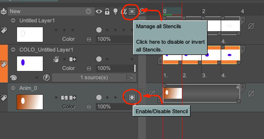

But in the current TVPaint interface the term used is "Stencil" , not "Mask" --
Screen Shot 2021-09-26 at 12.54.45 PM.jpg (22.59 KiB) Viewed 87941 times
Screen Shot 2021-09-26 at 12.50.55 PM.jpg (84.78 KiB) Viewed 87941 times

Thanks for the notice David!
I've just checked on a TVPaint 10, and it was written "Mask On/Off" as well.
The documentation screenshots were taken before we renamed the feature to "Stencil" (and that part of the documentation was also written before that change).
We'll change that as soon as we can :)
