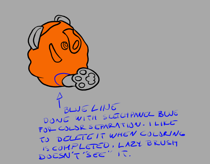

It seems the lazy brush can't see if you have colored outlines. At least in some situations. I made couple of tests and sometimes it sees the colored outlines and sometimes not. I like to use colored outline made with tvpaint scetchpanel for color separation. When coloring is completed I can remove them wtih X at scetchpanel. Now it seems the lazy brush doesn't understand my colored lines.Is this possible to fix?
M.
EDIT: It seems to work if you first paint with the other color and the paint goes thru the line but when painting the next color it works..But it tcalculates it a while. I can see the spinning beach ball of death in my osx before the paint is done.

Are you sure you have drawn the line on the correct layer?
Is it possibile for you to upload an example file with the problem, or send us a link?
We will fix it, and it sounds like a very valid workflow
Thanks

oferk wrote:Are you sure you have drawn the line on the correct layer?
Thanks
Sorry, everything works correct. I'm way too tired for work or coloring. Deadlines... I should think twice before posting. :oops:
