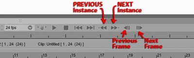

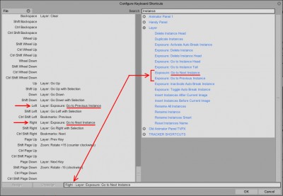

Wayne Carlisi wrote: 28 Mar 2019, 01:41 "Does anyone know how to scroll through the timeline and not have to see each frame? Meaning the drawings and not the frames."
Keyboard shortcut Right = Go to Next Instance , Keyboard shortcut Left = Go to Previous Instance
which is different from Keyboard shortcut . (period) = Go to Next Frame and Keyboard shortcut , (comma) = Go to Previous Frame.
[click on the images to view them larger]
https://www.tvpaint.com/doc/tvp11/index ... es-general
Any of these keyboard shortcuts/hotkeys can also be assigned to Wacom Express Keys or Touch strips/Touch wheels .
ALSO , in the project interface on the Playback toolbar , there are buttons for Previous Instance and Next Instance,
Previous Frame and Next Frame.

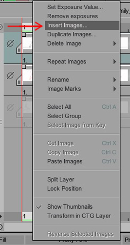

Also, what is the hotkey to create a new instance on a High Sierra Mac?
Thanks,
Wayne Carlisi

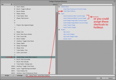

It would be the same hotkey used to create a new instance on any other version ... all keyboard shortcuts are listed under Preferences > Shortcuts
If you search the Shortcuts for Insert , you'll get a few options:
- Insert New Instance (same as the Handy Custom Panel command Insert New Instance) .
or
- Insert Instance Before Current Image
- Insert Instance After Current Image
Any of these shortcuts could be assigned to a hotkey. In the attached image I have Insert New Instance assigned to the W key (it can be any key you want)

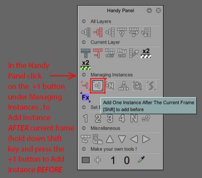

The same command to Insert Instances is in the Handy Custom Panel:
https://www.tvpaint.com/doc/tvp11/index ... nced-handy
If you Right-Click on the Timeline , one of the options on the pop-up menu is Insert Images (although to be consistent this should actually say "Insert INSTANCES" )
Anyway, any of these methods will work to insert new blank instances on the Timeline .
