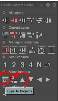

Okay, so a nice person Karin from tech got back to me and told me this: Hello Joe, Thank you for contacting TVPaint Développement. My name is Karin and I will be your contact.If have several clips in your project, and want to transform them into separate projects, you can do the following
Go to the project in the timeline <image002.png> then open the Handy Custom Panel at the left from your canvas,
under “Miscellaneous click on <image003.png> clips to project.
I have also attached two screenshots.I hope this is useful.Best Regards

JoeMurray wrote: 12 Jan 2023, 16:01 Okay, so a nice person Karin from tech got back to me and told me this: Hello Joe, Thank you for contacting TVPaint Développement. My name is Karin and I will be your contact.If have several clips in your project, and want to transform them into separate projects, you can do the following
Yes, that button in the Handy Panel should do what you want to make each clip in your master project file into separate TVPaint project files. (I usually do it from the right-click pop up menu in the Project tab, but because you are having trouble accessing hat menu , the Handy Panel shortcut button will do the same thing.)

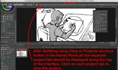

JoeMurray wrote: 12 Jan 2023, 16:21 So where did the projects go?
The project tabs should be displayed along the top of the TVPaint interface.
Please post a screen shot of your TVPaint interface after you have done the split clips procedure (using the Handy Panel shortcut button Clips to Projects).
