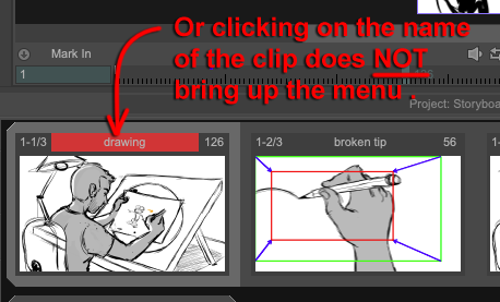

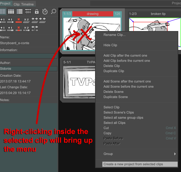

Trying to replicate your issue I find that if I right-click on the name of the clip or around the outer edge of the clip window the menu does not come up , but if I right-click inside the selected clip (on the image) the menu appears.

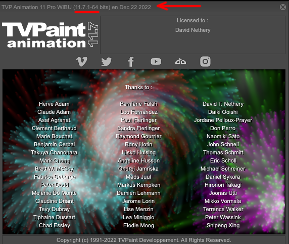

I'm out of ideas. You should be able to pull up the menu that has the option to Create New Project from Selected Clip if you're using TVPaint 11.5 or TVPaint 11.7. I can't figure out why you would not be able to access that menu. If you are working on a version of TVPaint that is older than v 11.5.3 I would suggest you log in to your TVPaint account on the main TVPaint website to update your software. I don't remember exactly at what point the "Create New Project from Selected Clip" function was added , whether it is in the older versions of TVPaint 11 or 11.5 , but I do know for sure it is in version 11.5.3 and in 11.7.1 (the current version).
NOTE: to find out exactly what version you are using , click on the Help Menu in TVPaint > About TVPaint , to bring up a window with the version information.

To find the specific version of TVPaint 11 you are currently using , click on the Help Menu in TVPaint , then select About TVPaint from the Help Menu. That will open up a window that has your version of TVPaint listed on the top bar of the window.
