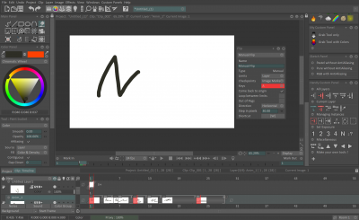

Here you can see a screenshot. For example, here I want to skip some frames and see only the frames with red imagemark . But I don't know how to activate this.

The shortcut key you're using for this Flip is W . So holding down the W key , with your pen cursor touching the surface of the tablet, as you move it left to right and right to left ... that action should flip between the images marked with the Red image mark.

Yessssss. It works. Thank you.
