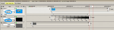

Peter Wassink wrote: 02 Jul 2013, 20:16 actually you can do a cross-fade by using the blend modes, its slightly counterintuitive and you do need an extra layer
but its not destructive (other then having to reset the blend modes of the layers involved.)
This is how:
The behind mode puts the top layer virtually under the bottom layer where its revealed because the bottom layer is increasingly being erased by the fade layer.
I made a video tutorial to produce a non-destructive cross-dissolve (using blend modes) based on Peter's method, although in comparing the layer and fade set up in the screenshot from Peter to my set-up there are slight differences. But at any rate , my way of doing it in the tutorial was inspired by Peter's clever idea of using blend modes to accomplish the cross-dissolve effect.
https://www.youtube.com/watch?v=QlRpAPY-Z8w
(if you want to watch the tutorial in Full Screen mode, click through to watch it on YouTube , because for some reason the TVPaint Forum does not allow the option to play embedded YouTube videos in Full Screen mode.)

Léo
