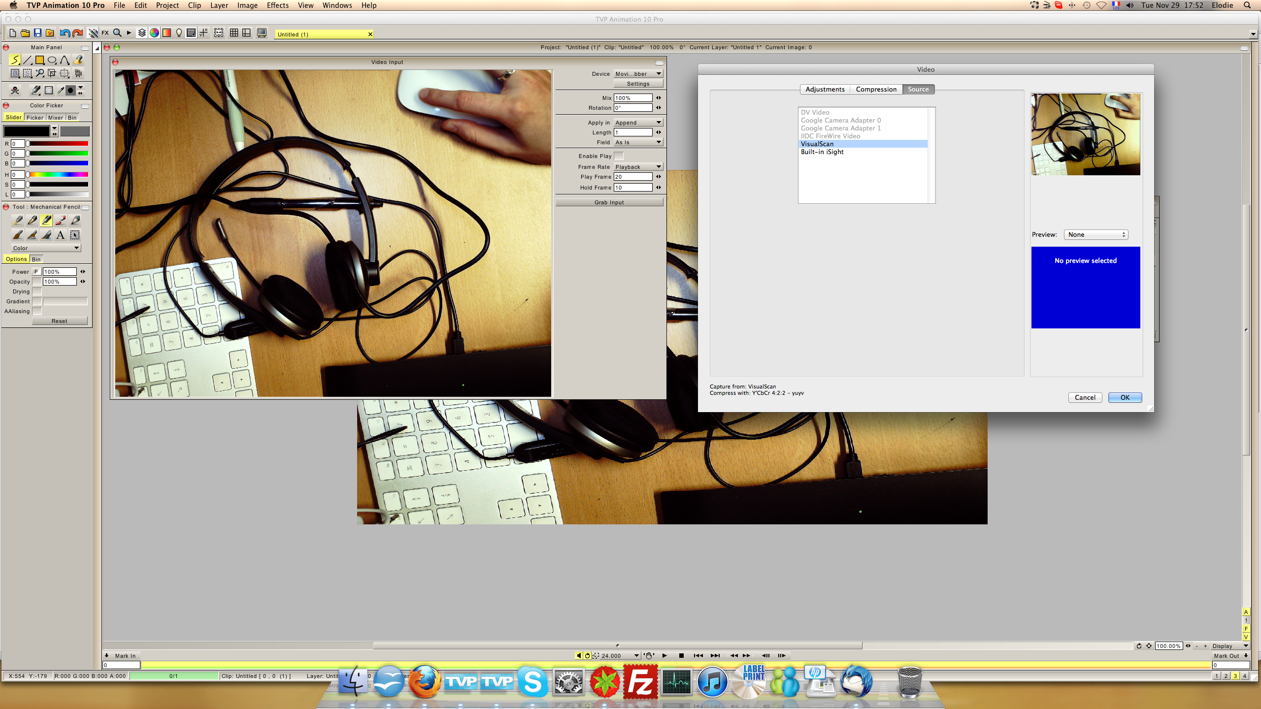

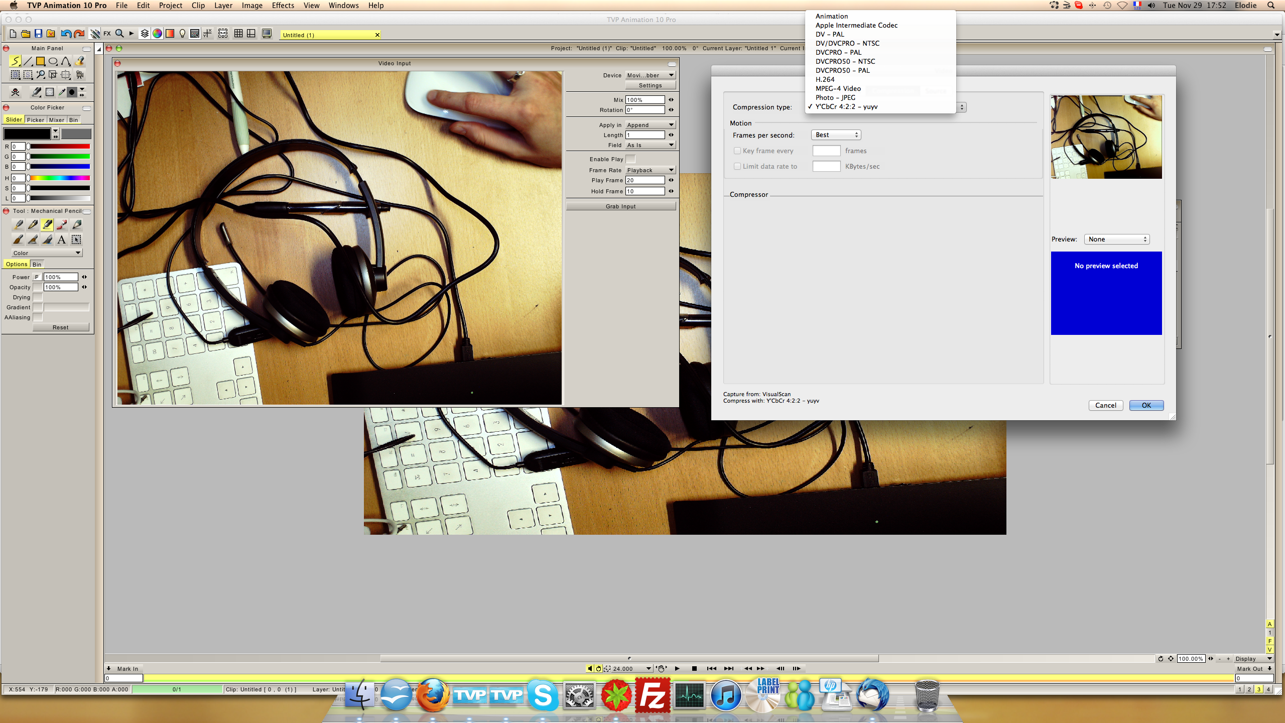

Here are the different tabs accessible via an iMac :

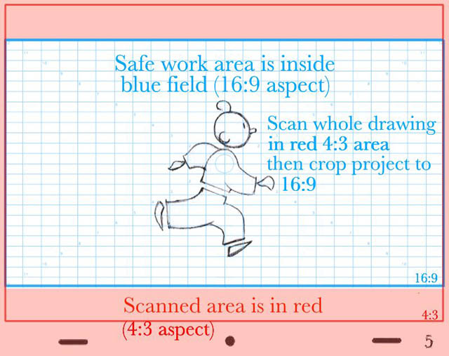

This is also the answer I got from a representative of RecordeX-USA (Jason Ulmer) who replied regarding my questions about resolution and screen aspect ratio:
Regarding Aspect Ratio ("4:3" vs. "16:9") whether it will capture in aspect ratios like 1920 x 1080 ("16:9") Jason Ulmer responds:
The camera simply captures images at the resolution it is set for. The max resolution that we support in our software application that is designed for school classroom use is 2592x1944. This is a 4:3 ratio. If you need to capture work for 16:9 you'll probably need to capture and then crop the images. Perhaps the software you are using is able to automated this cropping/refitting operation ? Our camera will simply capture an image at the resolution it is set for. Anything that happens after that is the software.
So it seems to me that the Simplicity Cam 5e will only capture to 4:3 aspect ratio , otherwise the image will be stretched/distorted to fit inside 16:9 aspect ratio, yes ?
Therefore the workaround for using 16:9 would be to scan the whole drawing at 4:3 ratio , but make sure that all animation is within a "Safe Area" using a 16:9 field guild , so after capturing to TVPaint , then run the Scan Cleaner and Peg Hole Registration , one additional step is to crop the image to a 16:9 project size . Am I correct ?
Re: An interesting piece of hardware.
hi D.T.
if you shoot with a camera mounted, and use a peg-bar to recieve the anim' drawings, your image is correct,
if you don't use a fixed pegbar for the shooting (just aligning the drawing's peg-holes on a black tape f.i.),
and then go to the peg-hole Registration FX of tvp to make them steady, you should have your 4/3 scanning area
including the paper holes .
instead of cropping, I personally use the keyframer (source project = shooting res.,target project = 16:9 HD),
it's quite the same result at the end. :wink:

ZigOtto wrote: instead of cropping, I personally use the keyframer (source project = shooting res.,target project = 16:9 HD),
Good idea.
