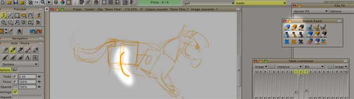

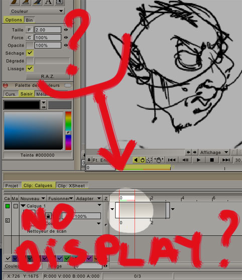

Hello
Here is a list of capricious "refreshing troubles" I might encounter .
("capricious" because they're not reliable*…only appearing from time to time)
- When I "stamp in place" a brush at the end of a layer… the new image is sometimes not refreshing.
(it's a new one)
- When using the blue/orange sketch panel… sometimes, the line is very big… you are obliged to activate another option (let's say "rectangle or filled ellipse")… and to come back in the sketch panel to get the regular stroke back… (encountered for a long time)
example :
- When stamping a picture at the beginning of a new layer… the visualization is sometimes not effective. (new one)
… I have been smart enough to catch it… here you are :
Is there a refresh option inside TVP to solve these little refreshing problems… or anything to fix elsewhere ? (preview settings or somethings ?)
* reliable bugs are required :D !
ematecki
Posts: 2267
Joined: 15 Feb 2006, 14:32
Re: Update 9.5.20
Post by ematecki »
Are you sure you have anim layers, not image layers ?
Because image layers don't display their content in the timeline.
chatbraque
Posts: 335
Joined: 06 Jun 2009, 09:36
Re: Update 9.5.20
Post by chatbraque »
THX a lot !
You must be right … actually, I'm rarely using imagelayers, it must have been a slip of the stylus ;o((
(but ?… why don't they display their content in the timeline ?)
… I do maintain the 2 others :D
