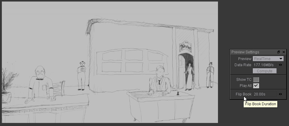

english manual wrote:In TVPaint Animation Pro, the preview ratio quality is automatically set, depending on the data rate
of your temp drive.
In other words, the data rate automatically change the size ratio of your preview to play it as well
as possible regarding the playback frame rate of your project.
The temp drive is the drive containing the temp folder that can be chosen in the
preference panel. (See lesson 1.)
You can use the test button to determine the data transfert rate of your temp drive.
The quality ratio will be reduced if you decrease the data rate value.
It is not advised to set a higher value than the one TVPaint Animation Pro
computes when you click on the Test button. If you do so, the quality ratio will be
increased but the sequence won't be played fluently anymore.
The Show TC button is used to display the time code during pre-viewing.
The Play all button forces the program to display all fields and images during viewing even if this
affects the display rate of the chosen images.
As exemple, below a picture of the data rate setting effect in the playback image quality.

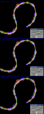

Paul Fierlinger wrote:-- all my playbacks look pretty much the same.
same here, but FlipBook gives better results (shots at 34,51 % of 2048W/1152H ):
with flipbook
with flipbook
Klaus Hoefs 04.jpg (45.85 KiB) Viewed 28347 times
normal
normal
Klaus Hoefs 03.jpg (52.91 KiB) Viewed 28347 times
