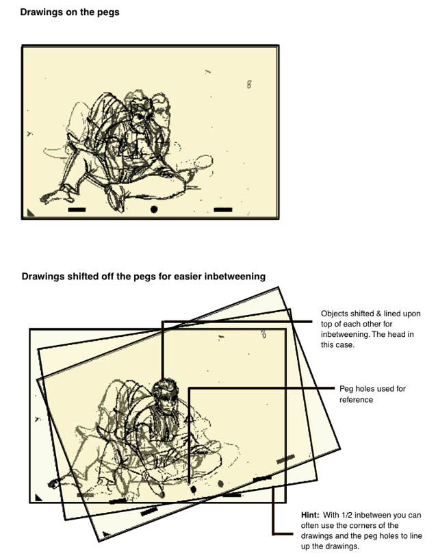

Slowtiger described it well. Here's a visual to further explain (pulled from a little booklet prepared by Jon Hooper and Michel Gagne , for training new inbetweeners called "10 Steps to a Perfect Inbetween" on the site AnimationMeat.com)

slowtiger wrote:Pulling drawings "off the pegs":
I have my two existing drawings A and C and want to inbetween B. The characters on A and C are very far apart or tilted to each other so an inbetween is difficult to do. Assistant's trick: first I roughly indicate on a new sheet where my inbetween B is going to be. Then I take one of the drawings A or C off the pegs and place it over the other so the character aligns, and place sheet B on top. Now the inbetween B can be created easily, but is off the pegs as well.
The corresponding function in TVP would need to handle at least 3 drawings "off the pegs", with an indication of their original position. In real life this would be the corners of the paper. In TVP this could be a set of two crosshairs left and right from the center of the drawing.
The function would need translate, rotate, and scale, since all of these apply to inbetweening.
Don't know if this was clear enough, next week I could do a sketch of this.
