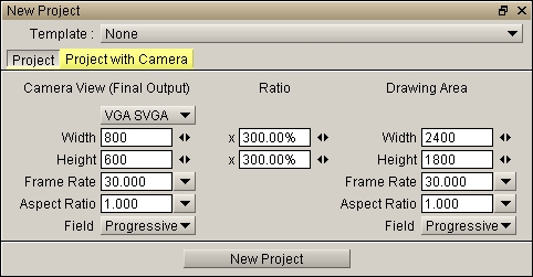

did i not post a reply before? anyway, thanks!! i got my version updated! but i still dont know how to drag the image - it keeps being cut out. the camera tool seems to work though, but i can't move my image.

with Camera tool, you need to think differently, you don't have to move the BG, but move the camera on a still BG :
make your project's size the size of your whole BG, and set your camera's size the size of your output.
... to learn how to work with the camera tool, have a look at the whatsnew.pdf (Appendix tvpa 9.5, p.13>15).

thanks a lot! now i finally got it to work :D
