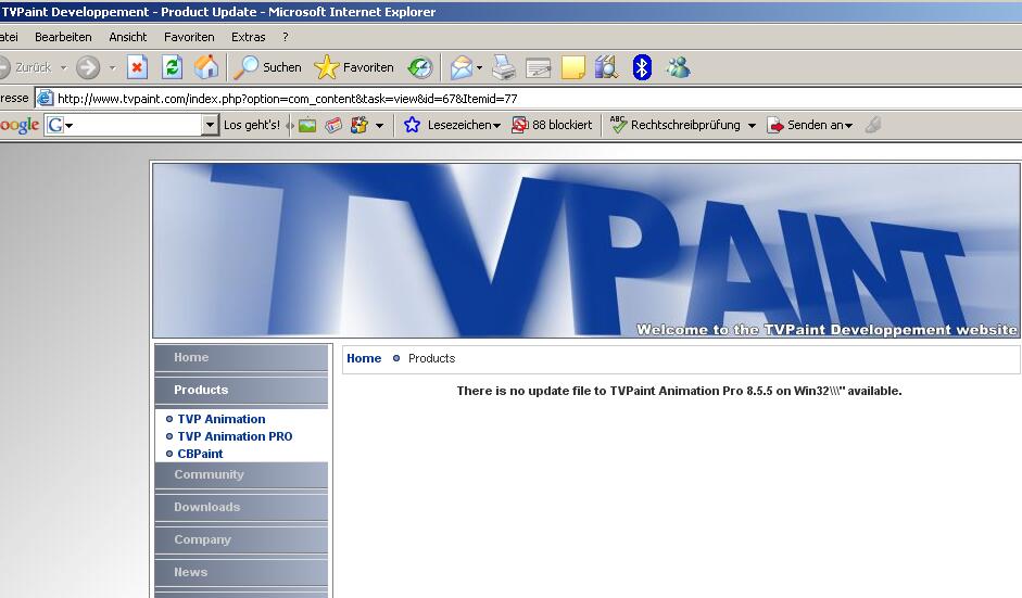

it must be a problem on my side when I try to check for updates, again I get this: (but I could download the update manually)

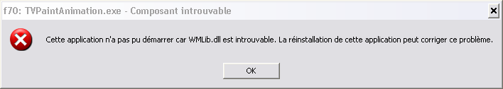

WMlib.dll missing ?
I've updated my tvpa version (from 8.1.1 to 8.5.7),
but now, when launching tvpa, I get this message (see pict.)
though, after an "OK" , everything seems to work correctly.
Hervé
Posts: 3490
Joined: 08 Feb 2006, 17:00
Location: Metz France
Re: WMlib.dll missing ?
Post by Hervé »
ZigOtto wrote:I've updated my tvpa version (from 8.1.1 to 8.5.7),

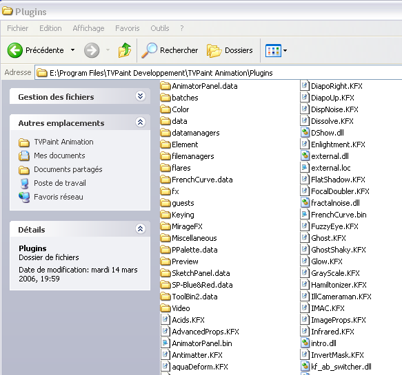

Remove c:\Program files\TVPaint Development\TVPaint Animation\plugins\dv.dll
dv.dll cannot be here by himself, Zig, Don't try to customize your configuration !
after verif, I haven't any dv.dll file in the Plugins folder .
and why the previous version didn't popup the message?
(I've updated in Repair mode).
ps:
I found the dv.dll in the Preview sub-folder, but I don't know how long for it's here ???
anyway, ... removed.
