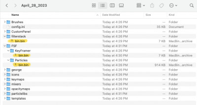

  • When exporting FX settings, the bin name should no longer be "bin.bin" but instead the FX name. For example, if you export the Keyframer settings, the file will be "Keyframer.bin". You might need to refresh your configuration for this change to be applied. Works ... but continues to have a problem with the correct naming of the exported file, attaching the name of the previously exported FX to the current FX being exported , instead of using the name of the current FX. So the user must manually change the name of the FX being imported in the Save As window.
    Also, in the main TVPaint config folder the FX Bin files continue to be displayed with redundant name of "bin.bin" for every FX category instead of naming them properly as "Keyframer.bin" , "Multiplane.bin" , "Particles.bin" , etc. . All are named "bin.bin".

Could you let us know if you are exporting your bins to those folders specifically (it seems you are within TVPaint's config folder there)?
Those bins are automatically created within this folder on macOS upon exporting a FX bin. The "bin.bin" name will be used there, even if the chosen exported name was different. This seems to be old code and the developers are currently investigating this to understand why this creation of such duplicates happens in the first place.
I can confirm that the FX bin naming works with a fresh config on my end. However, if you change the default name to something else, TVPaint will remember the last name you entered and use this in place of the default effect's name afterwards.

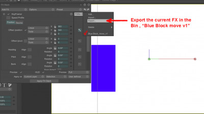

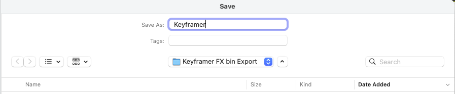

Here is how it now works for me when exporting an FX from the bin in 11.7.1 (hotfix April 28, 2023) -
Current FX in the bin is Blue Block move v1. Click on Export.

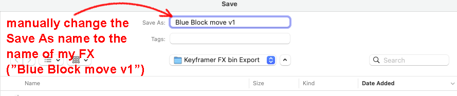

When the Save As window opens for the first time the FX name is "Keyframer". I must manually change this to the name of the current FX I am exporting: "Blue Block move v1"
Screen Shot 2023-05-05 at 10.16.20 AM.png (21.58 KiB) Viewed 17999 times
Screen Shot 2023-05-05 at 10.18.25 AM.png (18.42 KiB) Viewed 17999 times
Then the final result is this:
Screen Shot 2023-05-05 at 10.11.10 AM.png (24.21 KiB) Viewed 17999 times

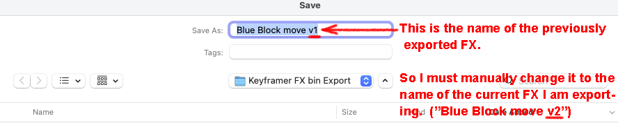

However, if I want to export another FX in the Bin , this one named "Blue Block move v2" when I click on Export the name in the Save As window is "Blue Block move v1" (the previously exported FX) , but it seems like it should be the current FX that is being exported ( "Blue Block move v2" ) instead of having to manually change the name each time.
Screen Shot 2023-05-05 at 10.22.35 AM.png (73.83 KiB) Viewed 17999 times
Screen Shot 2023-05-05 at 10.24.41 AM.png (17.54 KiB) Viewed 17999 times

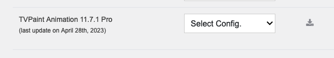

I'm glad I checked back to this thread and happened to notice the edit in your post from May 3, because I've been checking on the website to see if the fix had been released, but the website still says: "last update on April 28th, 2023". (so I would never have known to download it if I had not seen your edited post above)
Screenshot taken Monday morning, May 8, 2023:
TVPaint last update on April 28 2023.png (14.2 KiB) Viewed 17919 times

We have updated the information on the website, thank you!
