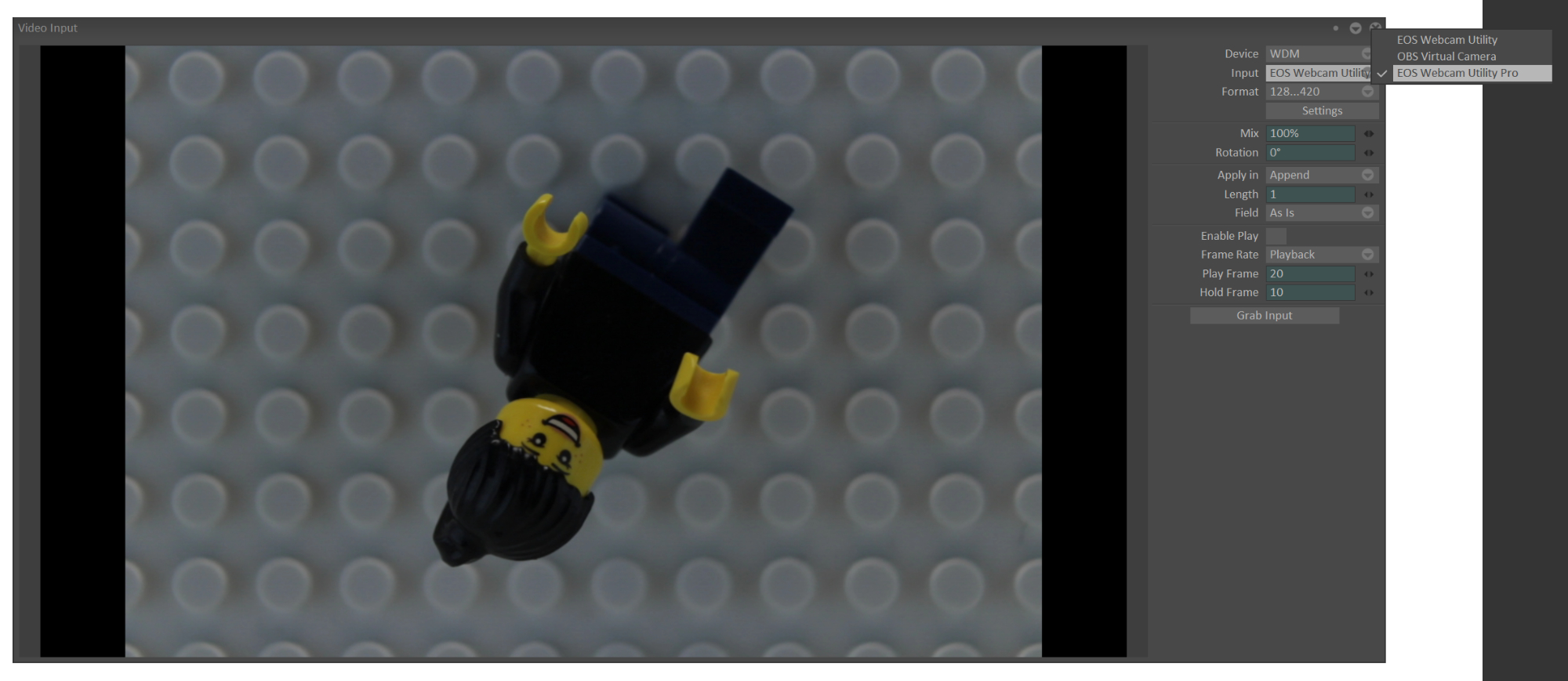

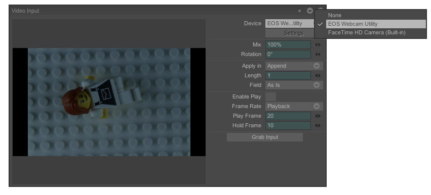

D.T. Nethery wrote: 04 Dec 2022, 18:44 I remember there was a list of specific Canon DSLR models that were compatible with TVPaint (on Windows-only) if you used the TVPaint Canon Video Plug-In.
It seems that TVPaint recognises a Canon DSLR if used via the EOS Webcam utility.
I only tested it on Windows and with one DSLR but Mac and Linux version of the utility are available.
It doesn't seem to capture at the DSLR's native resolution but the one of the Live view.
And the Settings button doesn't show anything.

D.T. Nethery wrote: 11 Mar 2023, 19:25 What's the resolution on the Live View ?
Well, in Dragonframe the video assist is 1056x704 but in TVPaint the only option I have is 1280x720 (which is a video format). I guess the utility fits whatever feed it receives into the dimension that a webcam would offer. It does means that black lines on either side are present in the captured images, as the DSLR's image format is not a 16/9 format.
I was able to try the utility on a macOS 10.13 (High Sierra), and it seems to be working.
Few things about it though:
  • the Settings button is greyed out, and I can't see what is the actual framesize of the captured image (as it automatically fits TVPaint's project size once captured)
  • and I needed to download the utility from this link for EOS Webcam Utility 1.0 or this second link for EOS Webcam Utility 1.1, instead of the link I first mentioned as it doesn't actually offer you the Webcam utility (not at least for the camera models I checked).
Also, I spoke too fast regarding Linux as Canon doesn't offer the utlilty for Linux distributions.
As a side note, on LinuxMint 21.1 Vera, for Dragonframe to recognise my camera, I had to install libsdl2.

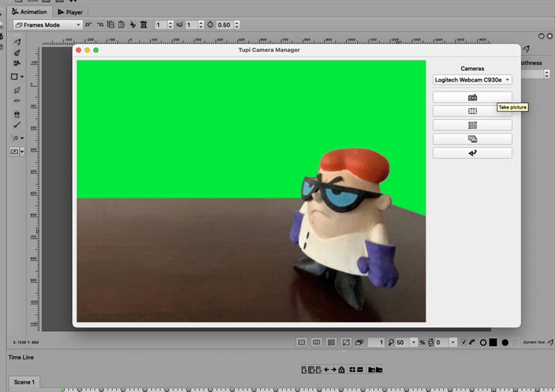

Here is another clue that may help with fixing the Video Input for Mac version of TVPaint 11.7 .

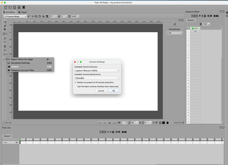

There is a free animation app I've used for students called TupiTube. TupiTube previously had video camera capture function to allow for capturing pencil on paper drawings or stop motion puppet animation. It stopped working because of new MacOS security policy (much the same as TVPaint's Video Input has stopped working)
The developer of TupiTube does the development work on the app on a part-time volunteer basis, so it took him a while to find the solution. But he seems to have found the solution. This is what he wrote to me:

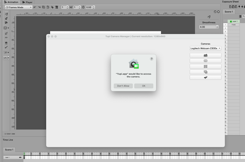

"The problem is when an app like TupiTube tries to access privacy-sensitive data (such as access to user's Camera) without a proper usage description in the info.plist. The app's Info.plist must contain an NSCameraUsageDescription key with a string value explaining to the user how the app uses this data. Then it will allow the user to click OK to access the camera. Here is a possible fix in the configuration file of the package: https://github.com/xtingray/tupitube.de ... Info.plist , but I don't have any way to test it because my only Mac computer is in the shop for repairs."
However , he released a beta version with the NSCameraUsageDescription key with a string value included as part of the app's info.plist. It works. You can download it here:https://www.tupitube.com/index.php?r=cu ... view&id=31 It is version 0.2.20 for Mac.
The code he included in the info.plist can be seen here: https://github.com/xtingray/tupitube.de ... Info.plist , as an example of what needs to be included in the info.plist so that the camera can be accessed. Perhaps this will provide a path to fixing the problem with TVPaint Video Input if a similar configuration is included in the TVPaint info.plist ?
Select the Camera capture mode and select camera -
Give permission to app to use Camera -

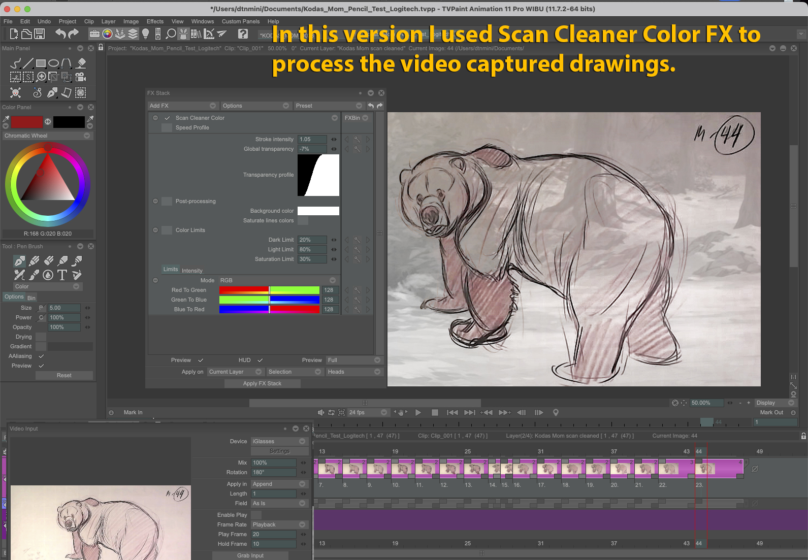

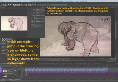

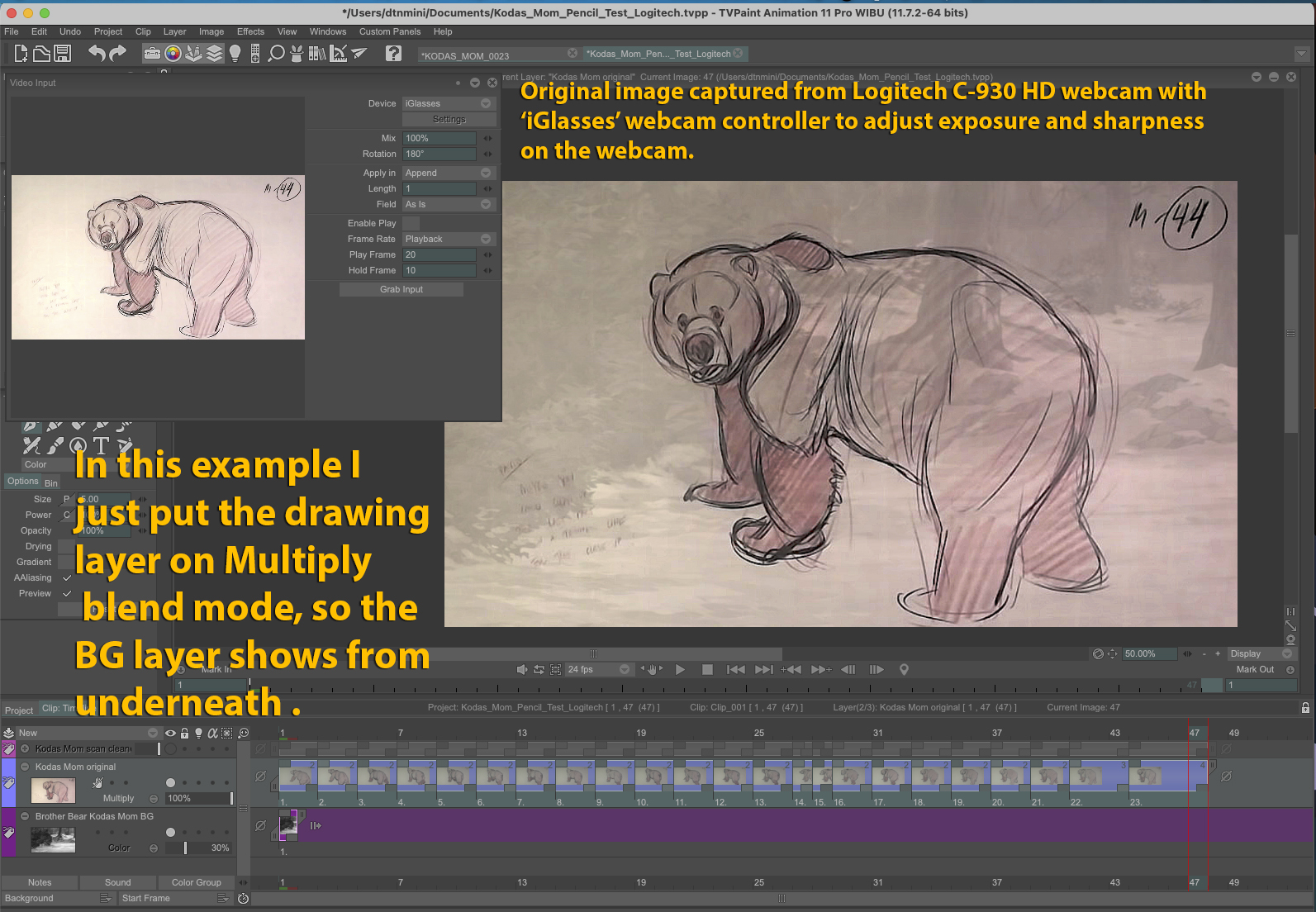

One thing I'm using the newly restored Video Input mode for is to capture various bits of animation (on paper) that I've saved over the years. (my scanner is acting a bit wonky these days, so until I can afford to replace it with a new scanner, it's really convenient to be able to shoot pencil drawings with my Logitech C-930 HD webcam.
In some cases if it's just one layer of animation over a BG the layer with the animation can simply be put in Multiply blend mode so the BG can show through from underneath.

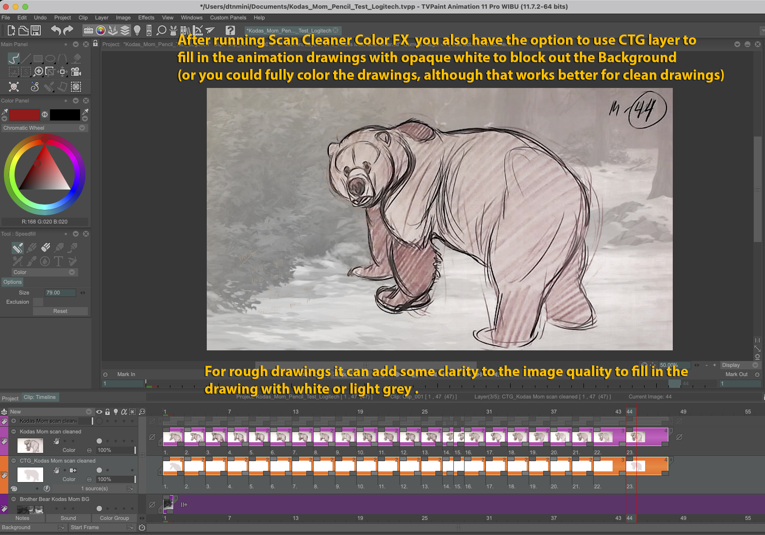

Or for more control over the image , use Scan Cleaner Color FX (maybe in combination with Histogram or another FX in the stack to tweak the image quality) so the drawings are turned transparent to allow the BG to show through from underneath.
