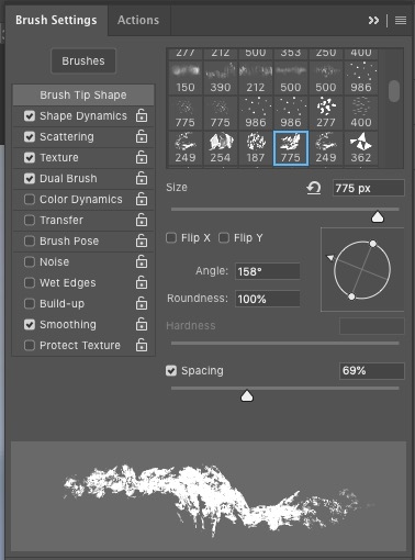

I haven't had too much success with duplicating Photoshop brushes. The main thing is that I don't quite understand how to translate the Photoshop brush setting parameters into the equivalent brush parameters in TVPaint, for example "shape dynamics" and "dual brush" .

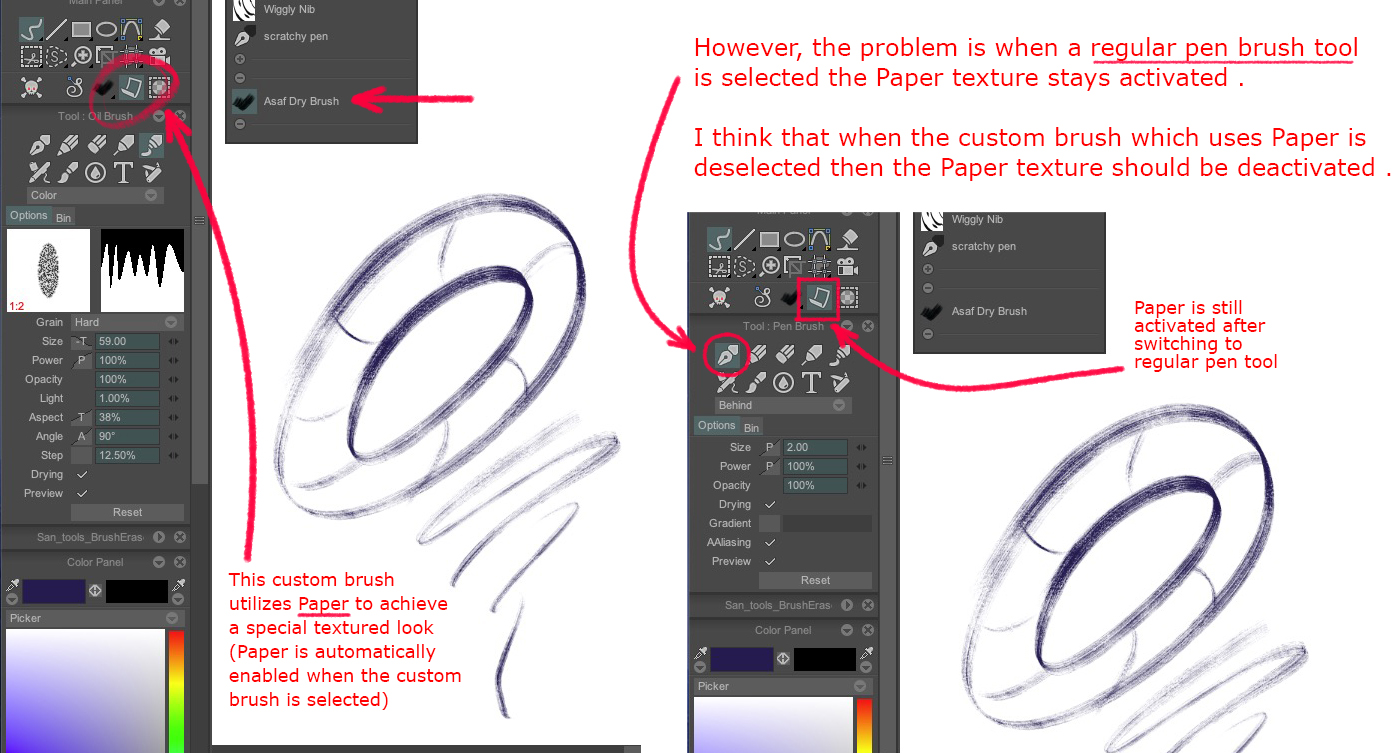

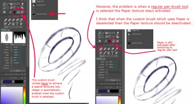

This actually reminds me of a long-standing question I have about using Paper as part of a custom brush tool
(maybe this question needs to be addressed to the developers because perhaps it is a bug? )
I notice that when I use a custom brush which makes use of the Paper texture , the Paper texture remains active after I deselect the custom brush and return to using a regular pen tool that does not have any texture. Is this normal behavior or should the Paper be turned off after I deselect the custom brush ?
It is not hard to turn off the Paper, but sometimes I forget to turn it off and it results in me drawing a stroke or two before I notice that paper is still active, so I have to undo and redraw the stroke(s).
I think the behavior should be that when a custom brush (which uses Paper) is deselected then the Paper texture should be automatically deactivated.
Posts: 1579
Re: Ink Brushes
Dave, I think there was a halfhearted attempt to rectify the problem when a grab current tool command creates a new custom brush, it began automatically adding the command: tv_paper Active 0, but that only works for that created tool button.
So +1 for your suggestion to somehow automatically deactivate paper when any custom brush or other tool using paper, auto-deselects paper.

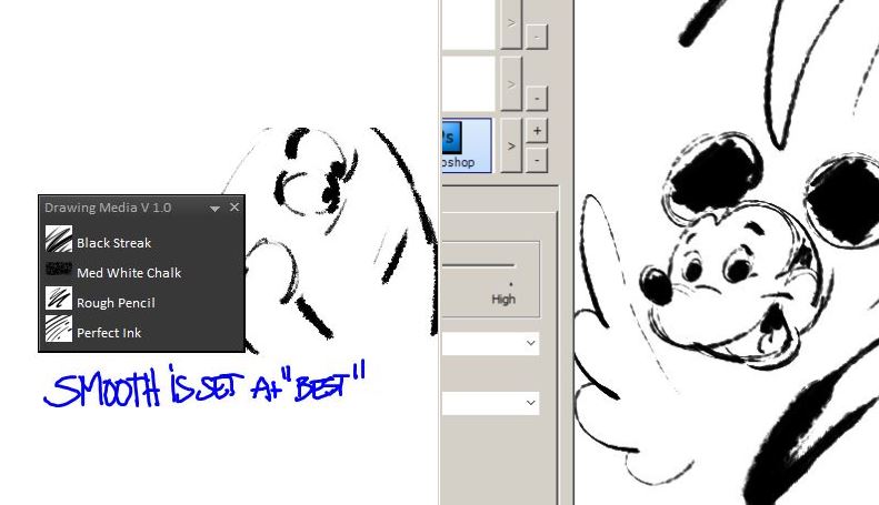

I just tried out "Cartoonmonkey´s" brushset.
Holy moly!! it is very close to what I need in this case.
Only thing compare to the PS brush is that it is very rough on the edges. The PS brush has a more soft look to it.
But I guess thats why the name. :) :)
A.

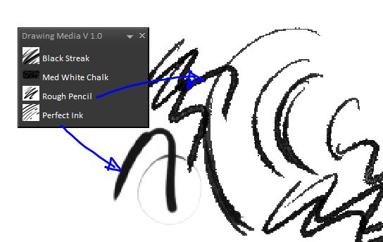

CartoonMonkey !?
Allow me to ask.
Is there a way to merge "Perfect-Ink" and "Rough Pencil" from your "Drawing Media V01" Brush invention?
So "Rough Pencil" is getting this smooth+soft look but still with the "Crazyness" (lack of better wording) ?
All the best have a great weekend :)
A.
