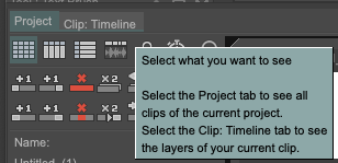

3.) At this point if you switch to the Project tab you should now have two Clips in your Project. (probably named by default as Clip_001_left and Clip_001_right, because the split clip has been moved to the left of the original clip, which is now Clip_001_right. (This is how it works now in version 11.7.1. If you are still on 11.5.3 then the resulting split clips might be named Untitled_left and Untitled_right , if you did not previously have a name assigned to the Clip. It doesn't matter, you can rename all the Clips later , using the correct Scene numbers, before you seperate them to individual TVP project files)
4.) The Clip_001_left will contain your first scene. Clip_002_right contains all the other scenes. So now return to the Clip:Timeline view and move to the end of your second scene , advancing to one frame after the end of the second scene (i.e. the first frame of the third scene) and repeat the Split Clip. Keep repeating this operation until you have reached the end and only one scene remains, all the others having been split off to their own Clips.

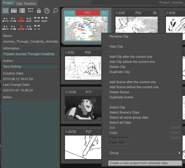

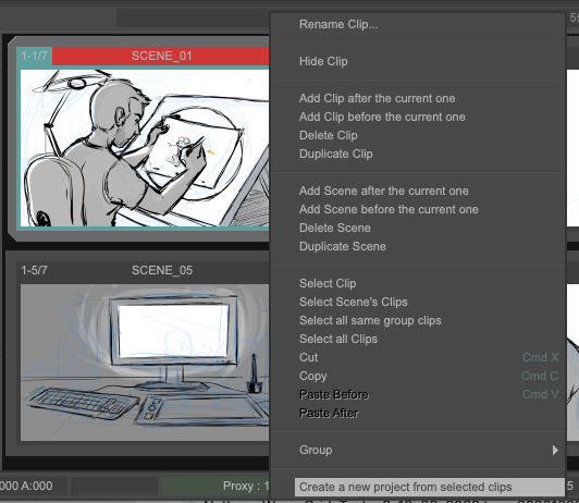

6.) Finally, when your project is split up into separate Clips, you will probably want to make each of those clips into a separate TVPaint project file , so when you are adding Color and Background layers the project doesn't get too heavy and start to lag when you attempt to playback the scenes to watch them. I have occasionally made a short project of about 3 minutes that is all contained in a single TVPaint project file, but even a 2 or 3 minute project can get quite large depending on the pixel resolution of the project (HD 1080p ? or 2K ? or 4K ?) and the number of layers and effects added from the FX Stack (using KeyFramer tool or Multiplane Camera or WarpTool, etc. Some of those FX Stack modes are quite intensive in terms of the amount of processing power and RAM they need to render). I would imagine an 11 minute project will get quite laggy (if it's not already laggy) when you start adding character fill color layers and full-color BG layers to it.
To split off each clip into a separate TVPaint project , right-click on the clip and from the menu select Create a New Project from Selected Clip .
7.) After you have split each clip to it's own TVPaint project file , go to File Menu > Save Project As ... and save the projects to wherever you save your project files on your computer hard drive or external hard drive . Do this with all of them. See screencapture movie -
