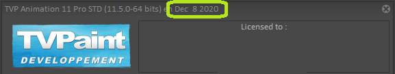

Which build date shows up in the about window ? It should be 2020/12/08.
