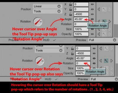

The labeling of the wheel/pointer as "Rotation" was one of the things that confused me about the actual function of the Rotation parameter in the Multiplane FX. I would move the "Rotation" pointer and see the Angle change in response , but nothing changed in the Rotation parameter. The Tool Tip pop-up which appears when the user hovers their cursor over the Rotation parameter should clearly communicate to the user that Rotation refers to the number of times the layer will make a complete 360°rotation (between two keyframes) -- 1 means one complete rotation , 2 means two complete rotations, 3 means three complete rotations , etc. The starting keyframe set to 0 and the next keyframe set to 1, 2, 3, 4 , etc.
However, the Tool Tip pop-up as it is now adds further confusion. Notice that if you hover your cursor over Angle the Tool Tip pop-up says it is for setting the "Rotation Angle" , but then if you move your cursor down to hover over Rotation the Tool Tip pop-up also says "Rotation Angle" . It should say "Number of Rotations" or something like that.

It is worth noting that values for angle and rotation are necessarily combined when representing any angular value greater than 359 or less than -359. For example an angle of 520 degrees would be Angle 180 and Rotation 1. And you just have to kinda "know" this because you'll never see 520 degrees displayed anywhere. :?
Multiple complete rotations of the circular pointer (CW or CCW) will automatically increment or decrement the Rotation counter.
