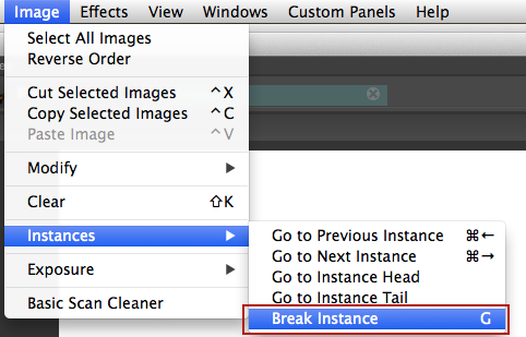

I have a question about instances in TVPaint 11. I am looking for the "Transform an Exposure into an Instance" and "Transform an Exposure into an Empty Instance" commands. Are these commands gone from 11 or moved to a new location? I can't find them anywhere, they don't seem to be listed in the keyboard shortcuts. They used to be found in the Animator Panel in 10.5. I can get that functionality back by exporting the Animator Panel from 10.5 and importing it into 11. I don't like how new instances are set before or after my current frame and that it adds to the overall length of a scene in 11.
For the most part, I do like the changes made and am excited to upgrade soon! Cheers and well done.

Padruig wrote:I have a question about instances in TVPaint 11. I am looking for the "Transform an Exposure into an Instance" and "Transform an Exposure into an Empty Instance" commands. Are these commands gone from 11 or moved to a new location? I can't find them anywhere, they don't seem to be listed in the keyboard shortcuts. They used to be found in the Animator Panel in 10.5. I can get that functionality back by exporting the Animator Panel from 10.5 and importing it into 11. I don't like how new instances are set before or after my current frame and that it adds to the overall length of a scene in 11.
Hi Padruig,
"Transform an Exposure into an Instance" in TVP 10 Pro = "Break Instance" under Image > Instances menu in TVP 11
You can assign a shortcut for this but I must warn you of a little confusing thing, when you go to shortcut, you'll find this command under the name Layer> Exposure: break
I find it confusing because of the use of instance and exposure, this can still get people mixed up :)
Shortcut01
Shortcut01
Screen Shot 2015-02-08 at 9.16.47 am.png (17.7 KiB) Viewed 32066 times
Menu01
Menu01
Screen Shot 2015-02-08 at 9.16.20 am.png (65.08 KiB) Viewed 32066 times
"Transform an Exposure into an Empty Instance" in TVP 10 Pro = this one is pretty much what you can do with "Clear" under Image menu in TVP 11, depending on your selection of instances or exposures
I hope this is useful!
Cheers,
A
Animator for Life
Mac | 3.5GHz i7 | 24GB RAM | OSX 10.9 | TVP 11 Pro 64bit

Ah yes, there it is! I knew it must be hiding somewhere. I still miss the transform to empty instance. The clear command only creates a new instance if you have auto-break active and I personally don't like this feature when animating and thus have it shut off. I can work around it though, I just like finding the little differences so I can better plan my workflow and shortcuts. Thank you for your help, much appreciated!

Padruig wrote:...I still miss the transform to empty instance...
For the "transform to empty instance" you can make a keyboard shortcut adding "Layer: Clear" to the "Layer Exposure Break" shortcut. Holding either "at" or "ctrl", I believe.
Or you can import the Animator Panel into V11 (after you've exported it from 10.5) and copy paste the buttons into a custom panel in V11. Or just leave the whole panel in.
