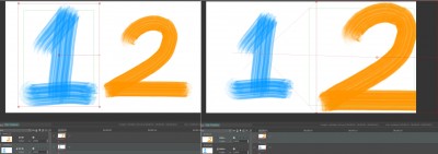

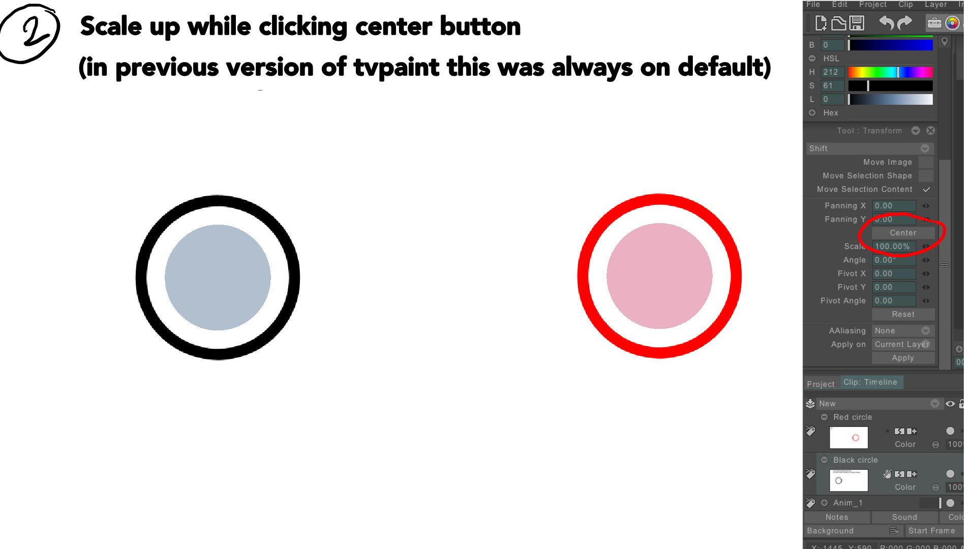

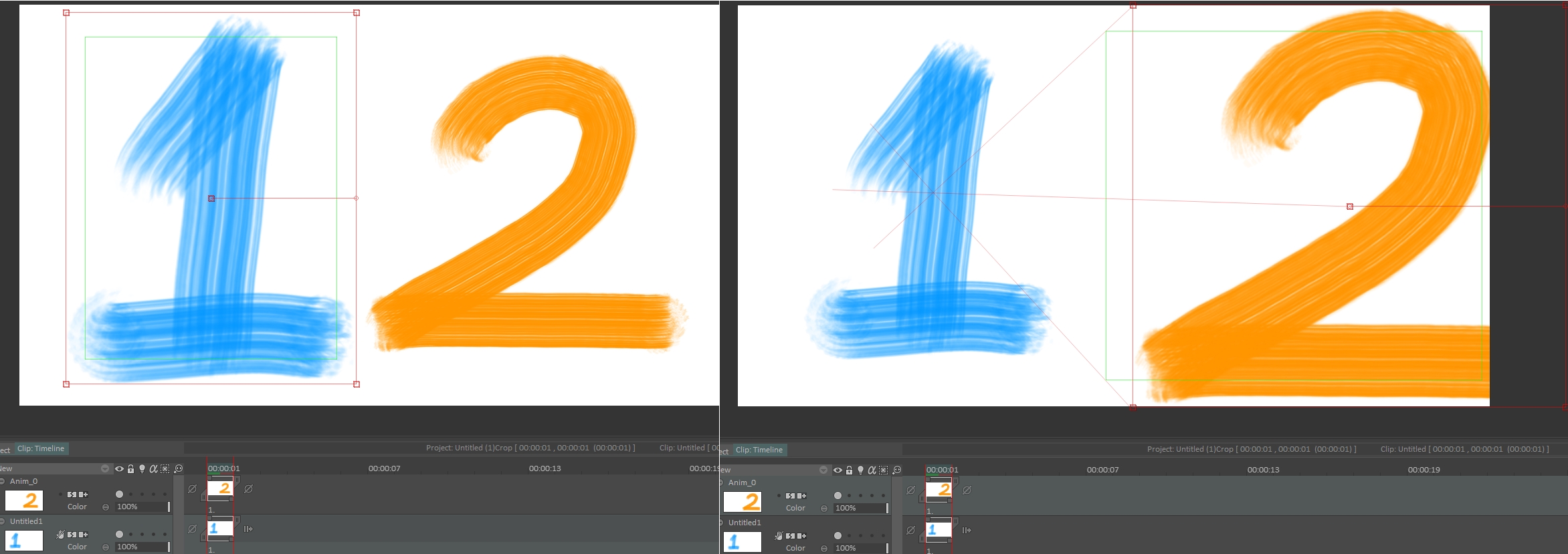

this image illustrates the issue:
the second transform uses the center from the first transform as its scale center

It's just like Peter says and asks, if there maybe is a way to set "clicking the center button" on default instead of clicking it each time when you scale up / transform something.
Here are some other little illustration I made that maybe could help to make it a bit clearer.
