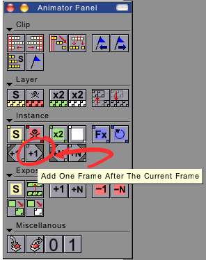

It's not an uncommon question for a newbie. There are a few ways to do this and it also depends on which verion of TVP you have and if you have a PC or MAC. The most basic way is to RMB on top of the layer, select Insert image and enter 1. Or make a key command:
Layer: Insert Single Image After Current Image.
Then there's a button for this in the Animator Panel and another in the Instance Panel (a plugin).

Animator Panel :
TVP User Manual Appendix , Section (D) , page 12 - 14. It should be in your TVP folder (appendix.pdf) or you can get it here:
