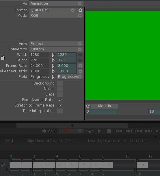

Thanks, but that is the method I used when I encountered the problem. Maybe there is something I don't understand, so I took a screengrab where you can see the settings in the timeline (8 fps this time) and the export window. The resulting clip plays 3 times faster than intended.

While exporting, you have to set the frame rate in 2 places: in the export panel, and in the video codec panel (like Quicktime) as well.
Overall it's not a really good idea to work this way, because in the end you'll have to stick to one of the official film/video frame rates anyway. Most work in 24, 25 or 30 fps right from the start. For a quick check like you want they just change the playback speed in TVP temporarily.
Re: 10 fps -> 24 fps
As explained Slowtiger, you use Quicktime, which means you also have to change the framerate there + disable "key image" function.

Thanks guys. I found that un-ticking "stretch to frame rate" in the export panel did the trick.

Yes, that was the name of the feature (not time interpolation...). My apologies, I answered you from my phone :oops:
