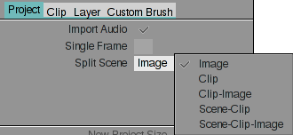

you have to name your images correctly and use the following option once you have the import panel.

What actually did the job for me was to use the clip option instead of image. That distributed the scanned images into separate clips.
Maybe i didn't explain well what i wanted to do.
