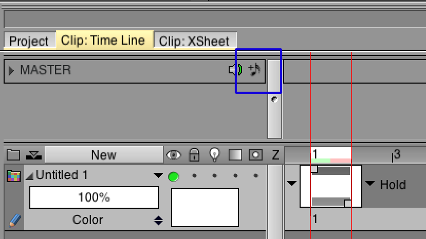

Oh ! I got you !
You cannot import / Load sound from this menu (it only works with images, videos or tvpaint files).
To import sound, you must open the sound drawer and hit the music note icon.
music note.png (17.13 KiB) Viewed 27068 times
