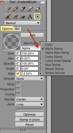

This might help you:
After cutting out a brush, set it to Alpha Stamp instead of Color. Now you can pick any color you like.
You can also save blue/red/green color swatches in the palette bin or in a custom panel.
alpha stamp.png (46.81 KiB) Viewed 16253 times

Re: Make CutBrush selection Blue/Red/Green
why not to make yourself the "one clic" tool that you need ?
f.i. once your brush cut (freehand-cut or whatever ...),
turn your new custombrush in Stamp mode + select the Blue Color (from Blue-pencil)
could be embedded in the same button, like this :
(of course, this button assignable to a hotkey),
idem for a "Stamp in Red" or "Orange", or another color from one of the sketch panels.
