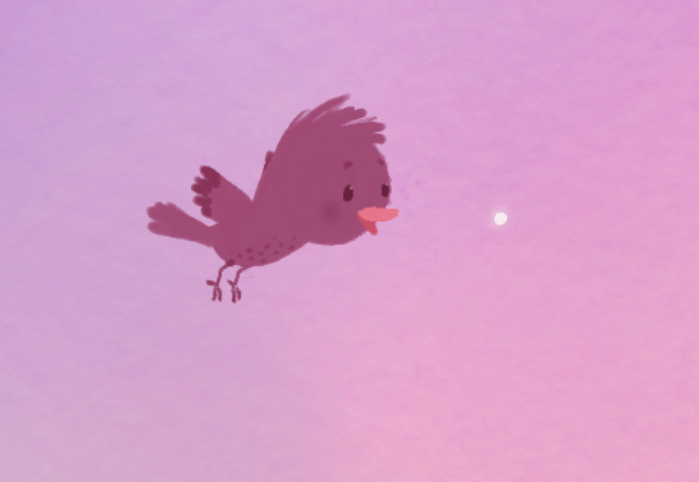

Thanks for the quick response!
I just did what you asked. Make a screenshot and export the picture from tvpaint as png. Opened them up in Preview, but they look different. I'll post them here for you to see what the difference is.
Screen Shot 2014-11-06 at 2.08.49 PM.png (282.5 KiB) Viewed 14622 times

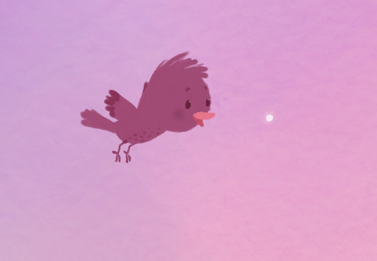

So in the previous post I have put the screenshot. In this post I have attached the PNG

This is very strange! Because I see no difference once i have posted it on the forum. However in Preview there defenitly is a difference!?

Most of the time, it's a color profile problem : TVPaint does not manage color profile and so, an image displayed in a this or that viewer can be a little different from TVPaint.
