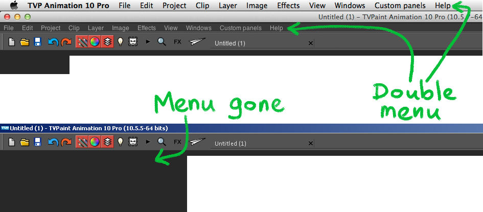

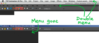

Currently, my configuration is fine on OS X:
  • "Use TVPaint Menu" under the "Interface" tab is disabled on OS X. (Because there already is a Menu Bar, there is no reason to have it there twice and waste screen space, see Mac screenshot)
  • The shortcut for "Preferences" is ⌘P
  • The shortcut for "Configure Keyboard" is ⌘K
When I start my Windows machine with loads my configuration from the dropbox I have no menu on top (see Windows screenshot), so I can't go to the preferences and turn the menu on. I can't use a shortcut to go to the preferences menu because ⌘ and windows-Ctrl are not the same. And I can't edit my shortcuts because I can't get there either.
Solution:
  • ⌘ should always be Ctrl on windows
  • Windows-Ctrl should always be ⌘ on Mac
  • "Use TVPaint Menu" should never be enabled on Mac
  • "Use TVPaint Menu" should never be disabled on Windows (I noticed the option doesn't even exist in the Preferences, so even if you could acces to Preferences, you wouldn't be able to turn it back on)
