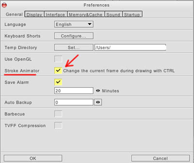

OK, give up finally. I have gone through the manual and not found the info I am sure used to exist where you could hold the CTRL key down and draw and the pages would flip automatically as you drew. I know it was a function in DPA, but I also think I could do it in TVP a long time ago. I can't remember if you had to select all the pages or not, but I have tried selecting and not selecting and an unable to make it work. Am I misremembering something? Thanks. Sierra

You must enable it in Preferences > Stroke Animator (change current frame while drawing with CTRL )

Oh thank you so much for your kind response. I am flipping out (heh heh).
