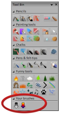

Another handy pair of buttons for storing unique brushes with a single click - can be found at the bottom of the Tool Bin panel of custom brushes that comes with TVPaint, in the last section called Your Brushes:
1. the Black and White Arrow button: Captures the current tool with parameters and cutbrush or animbrush into a button and turns the brush-imprint into the button's icon.
2. the Color button: Captures the current tool with parameters and cutbrush or animbrush into a button WITH APen and BPen colors and turns the brush-imprint into that button's icon.
If you edit either of these buttons you will notice they use the Tool Grabber command where you find the following menu choices pictured below:
What many people do is create a new, custom Brush Panel and copy over these two tool-capture buttons. Then each time they want to preserve a new custom brush they really like, they click either of these "arrows" and immortalize the brush inside a new button.
