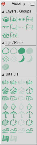

the image I attached shows what I'm trying to do...hopefully :)
I'm making some buttons that travel to the layers I need to go to often, so I don't have to manually find the layers (working on some projects with lots of layers), they work great, but now I only need to move the time-cursor if its next to the actual frames of the particular layer.
Is it possible with george?

Yes I do, it's a lovely shortcut :) But it only works if the layers are in the display, I often want to go somewhere even if its a hidden layer etc.
But I needed some more specific buttons. I'm working on a project for a long period, with 3 characters. And I made 3 buttons to jump to the specific character's line art and hide all other layers.

I did the same thing for props / FX / BG etc.
Every character has its layer this way:
Father line
Father shadow
Father detail
Father color
The second word is kind of like a secondary group... :) So for example, I can turn off ALL color layers in the entire project etc.
I'll try to share the whole panel when I can got the code less project specific.
