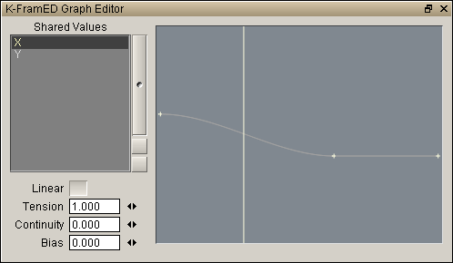

* ps : I can claim "it's possible" because it's (sort of) already existing through the KFramED plugin (a 12 years old plugin ... geez...),
the "Graph Editor" worked on every keyframable values, with independant curves, and in "Spline" mode (even if not "Bezier" type),
we could tweak them as well by modifying the "Tension", "Continiuty" and "Bias" parameters on each key,
so you could make some smooth (or abrupt) transitions regarding your curve design (see picts),
of course, you could add as many keys as wished within the timeline . 8)
