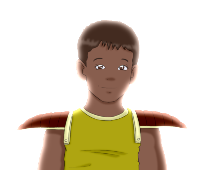

Is there any tutorial or good step-by-step explanation on how to get a Backlight effect using TVPaint ?
- Simple Backlight Effect
- Shon.PNG (139.43 KiB) Viewed 20567 times
Hi Dan,
here is a quick how to do :
* Choose the Magic Wand Select tool of the main panel
* In the tool panel increase the expand parameter and the smooth parameter.
* Click on the background behind your character. (I suppose this background have only one color or is transparent).
* Open a new layer.
* Fill in the selected area with the white color by using the floodfill tool of the main panel.
You can also use the new Stylise > Toonshading effect with the parameters below :
* Open a new layer.
- _toonsh_forum.jpg (33.91 KiB) Viewed 20533 times

Thanks for the quick respond fabrice !
I tried to do it as you said, kinda got lost while trying because my shots usually are so many layers (outline, color, highlight, tone, etc... <= all this for 1 character !) ...I wish TVPaint had Folders to group all those like in photoshop hehe.
Anyway, the screenshot I put for example is allready with backlight but not done in TVPaint, I just put it for example.
I'll try do something maybe more simple... then maybe I'll get the idea.
Thank you so much for the explnation, I hope I'll get it done.
