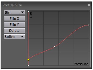

This has been discussed before but with search disabled I can't find the thread right now. Anyway, there is a work-around that you might try:
Select any brush or pen which is set to be pressure sensitive. Edit the tool's profile editor settings as follows... (the tool's profile editor is called up by right clicking on the P for the Size option in the tool's profile.) Set the left most curve point to 100 and the very next curve point to 0, then define the rest of the curve as desired. You might also want to do something similar for the Opacity's curve option so that the brush's unpressed appearance starts at full strength.
SH_002 Dec. 11 22.25.jpg (11.62 KiB) Viewed 32788 times
In this example, the cursor will show the brush a bit larger than its drawing size under fully depressed pen tip while drawing... For an exact representation of maximum size, set the height of the left most curve point = to the height of the right most curve point if you see what I mean.

Svengali wrote:This has been discussed before but with search disabled I can't find the thread right now. Anyway, there is a work-around that you might try:

It's because Tvpaint will show the preview based on the current size of the brush...not the max potential size...
So if you have your brush sized linked to pressure sensitivity, and your minimum pressure set to 0 radius, then you will not see the preview.
I find this to be a problem because sometimes you have no way of know how big your brush is and you end up painting a big blob by accident...
I think it would be ideal to have a brush preview that shows the max and minimum boundaries of the brush at all times.
Also, I've used the workaround shown, but that is not ideal to have to do every time.
