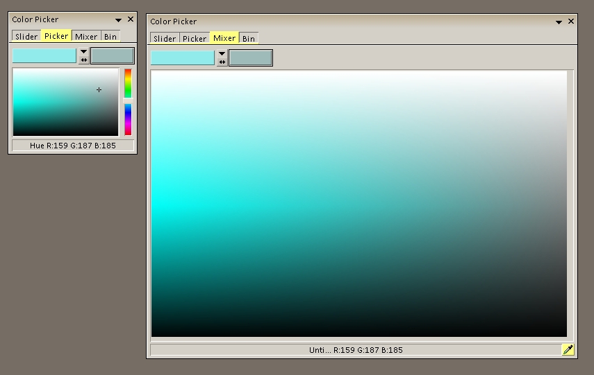

Peter was joking : the color picker tab can't be bigger, but the color mixer can (see one of my posts, on the previous page), in TVPaint 10.
But, I must say, I don't know how peter has done to put a color picker gradient in its mixer O_o
Did I miss something ? Or did you make a "montage" :mrgreen:

Elodie wrote: But, I must say, I don't know how peter has done to put a color picker gradient in its mixer O_o
screen capture ?
Re: TVPAINT ANIMATION 10 : Pre-order now !
The fake is confirmed, it was a joke (which will bring maybe a "last minute" new feature :wink: )

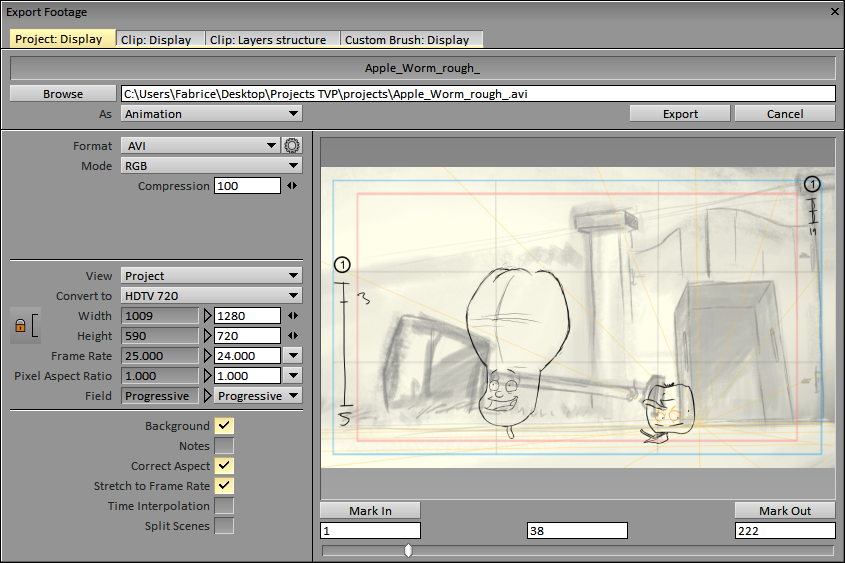

But let's go back to TVPaint Animation 10.
Here is an other screen capture : the new Export Panel, much more friendly :)

i am off course never joking:
-hold the colorpanel by its topbar press G
-Z scale the brush up
-put it down
- pick the gradient up as a custombrush
-export brush as imag
-RMB in colormixer> File > import the exported image as your mixer
ready
admittedly not the most practical but also not fake.

So the trick is to first turn the panel into a custombrush. Though smart, it's not very practical.
Wouldn't a feature request for a scale-able colorpanel be better?

Peter Wassink wrote:-hold the colorpanel by its topbar press G
-put it down
ready
Ooookay, for sure, it's not the most practical. I didn't think about save the color panel as an image and reloaded it into the Mixer. Not bad !
But I think that adding a real feature would be better, hehe :mrgreen:
