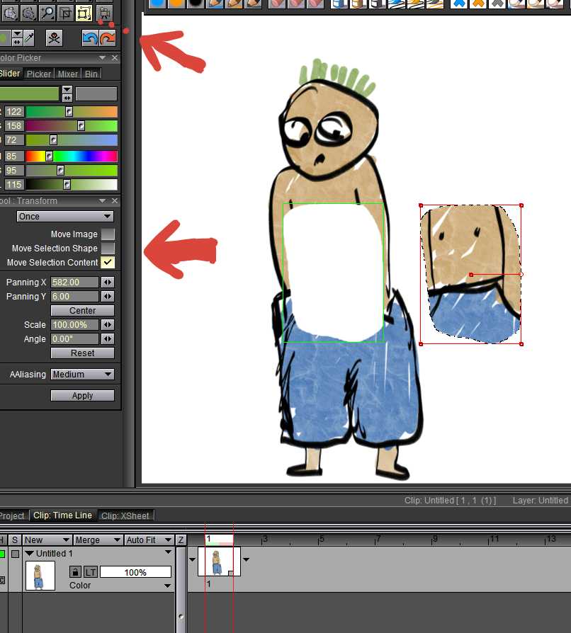

It doesnt work. if I go to the Tool: Select, and select a peace in the drawing, I go to Tool: Panning (Warp) und choose: Apply to Selection(not apply to Image). And move the drawing.But still it moves the whole drawing.

Post by Animark »
TVPaint 10.5.7 - Win10/64
TVPaint 11.0.8 - Win10/64
Re: Colouring and Stage
painterX wrote:... But still it moves the whole drawing.
I can't reproduce your issue here, but I've found another one (bug?) :
after selecting a part of the drawing, the Pan tool set on "Selection Content" when I click&drag to move the selected part,
it doesn't "apply" the moving the first time, I have to hit (for Undo) and [Enter] (for re-Apply) to make the change applied and effective.
maybe a "refresh" display issue ...? if I go on and move again, the 2nd time (and all others), it works as expected,
so only the first panning isn't displayed correctly in the project window.
Panning by using the Transform tool works fine.
Painter X : did you update your software ? That bug has been already fixed :)
