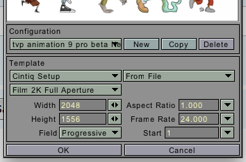

This is what the little custom panel looks like:
http://www.tvpaint.com/forum/download/file.php?id=4127" onclick="window.open(this.href);return false;
clicking on Start Frame 1 will change it from 0 to 1.
I always set my Start Frame to 1 in the start up panel and for particular projects I will start up from a Template , which is set to start from Frame 1.
