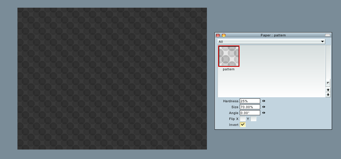

If I understand you well, you want to define that image as a paper, don't you ?
If so, you simply have to open it into TVPaint, then go into Windows => paper panel => scroll at the end of the papers list, right click in the "empty space" and "create a new paper". Here we are =)
