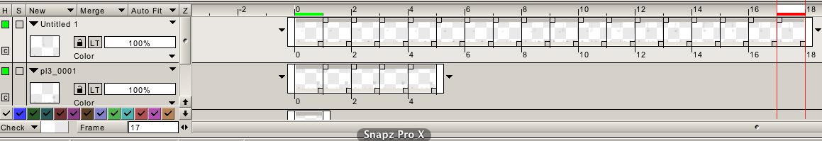

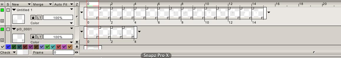

Hi,
I have a work project file where I organize all scanned images into layers, and then I render the camera in resolution for output, but, what ever I do, in the rendered project three frames are missing. As you see in the attachments, the two timelines are obviously different, and I'm certain that I didn't delete any frames myself. Is it some kind of bug? Did anybody else crossed on this problem? What should I do? I need every frame.
capture of original timeline
timeline of rendered project
p.s. four frames, I just noticed that in down layer one is missing also
TV Paint 11.5.3 Windows 10

I found what was the problem, It obviously creates some strange behavior when you try to render 30fps project with 25 fps camera. (I discovered this when I tried to change fps in original project and the same frames disappeared again). Maybe it is logical to everybody, but for me changing from 30 fps to 25 should preserve every frame. I solved this problem with exporting all frames as an image sequence and importing them again, but this time I was careful not to chose 30 fps from drop-down, but 25 fps. Now all the frames are here. So, I wonder, is it a bug, or this is some kind fps convention/standard which I'm not aware of?

It's possible that you didn't have the "Stretch to frame rate" box checked on the "Export Footage" window that comes up. Or it might need to be unchecked--I always forget and have to experiment with it if I'm changing frame rates like that.

You should train yourself to always use the same frame rate throughout a project. If you must change fps, alweays use "Modify Project" for it. Anything else will most certainly not give you the exact result you want.

slowtiger wrote:You should train yourself to always use the same frame rate throughout a project. If you must change fps, alweays use "Modify Project" for it. Anything else will most certainly not give you the exact result you want.
I agree, but I would like to point that I did use Modify Project and than I discovered that the same frames disappear when I change frame rate from 30 to 25. Then it became weird. And that's how I figured what's wrong. It's not a big deal, but I think it's good to know this in advance.

skomdra wrote:I agree, but I would like to point that I did use Modify Project and than I discovered that the same frames disappear when I change frame rate from 30 to 25.
in the [modify Project] panel, don't forget to uncheck the "Stretch to New FrameRate" option,
if this option is OFF, you can modify your project from one framerate to one other without modifying the layers's content.
