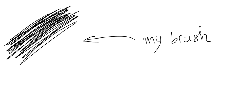

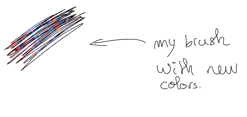

Concerning your brush, you simply have to put it on your drawing space,
active the stencil and change, for example, the color :
Then, use the tool that cut custom brushes and draw with your new colored brush.

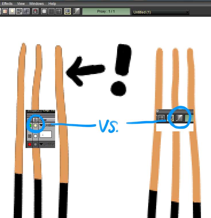

Hi Elodie,

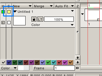

I used that Clipping Mask you recommend here in the past, to give some parts of a lineart a new color. But I have noticed, that there is a problem at the margins (borders) of the strokes where the half transparent pixels are. They stay a little bit shaded und you'll get a ugly colored line. I also noticed that this is not happen when using the "preserve Transparency" function from the top of the screen. That is what I would recommend here.
- Maybe there's something wrong with the "clipping mask" from the layer check boxes. Here is a picture to demonstrate what I am talking about.
- ClippingMasks.jpg (37.76 KiB) Viewed 20354 times
TVPaint 10.5.7 - Win10/64
TVPaint 11.0.8 - Win10/64
Re: clipping masks in tv paint
There is nothing wrong in fact. Just two different ways to do the calculations.
Indeed, you have to test the two possibilities.

I've never used that "preserve transparency" - thx for that tip! I just used the stencils with a "good enough" result.
