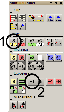

well, if your animlayer is all in one's, you can easily do that in one click (or hotkey) by making a custom button with these 2 commands :
- Layer : Select All Frames
- Layer : Exposure / Add Single.
(or by using the already existing buttons,requiring here 2 clics in the Animator's Panel : Layer / Select All Frames + Exposure / Add One)

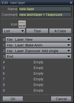

that said, my workflow is a bit different :
I've a custom button to create an AnimLayer of one instance in 2's, (see picture below)
then I add new Instances one by one, only when needed (ready to draw a new key or a new inbetween).
I must add my (Layer/Exposure) AutoBreak Instance option is Off.

I'm just adding an image to illustrate :
