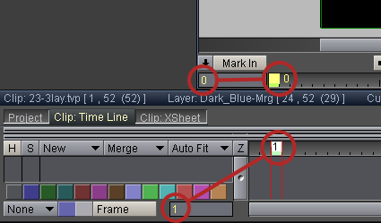

I would add the frame numbering in the remote-control bar at the bottom of the preview window is not "consistent" anymore
with the timeline panel when you change startframe 0 into 1. :(
